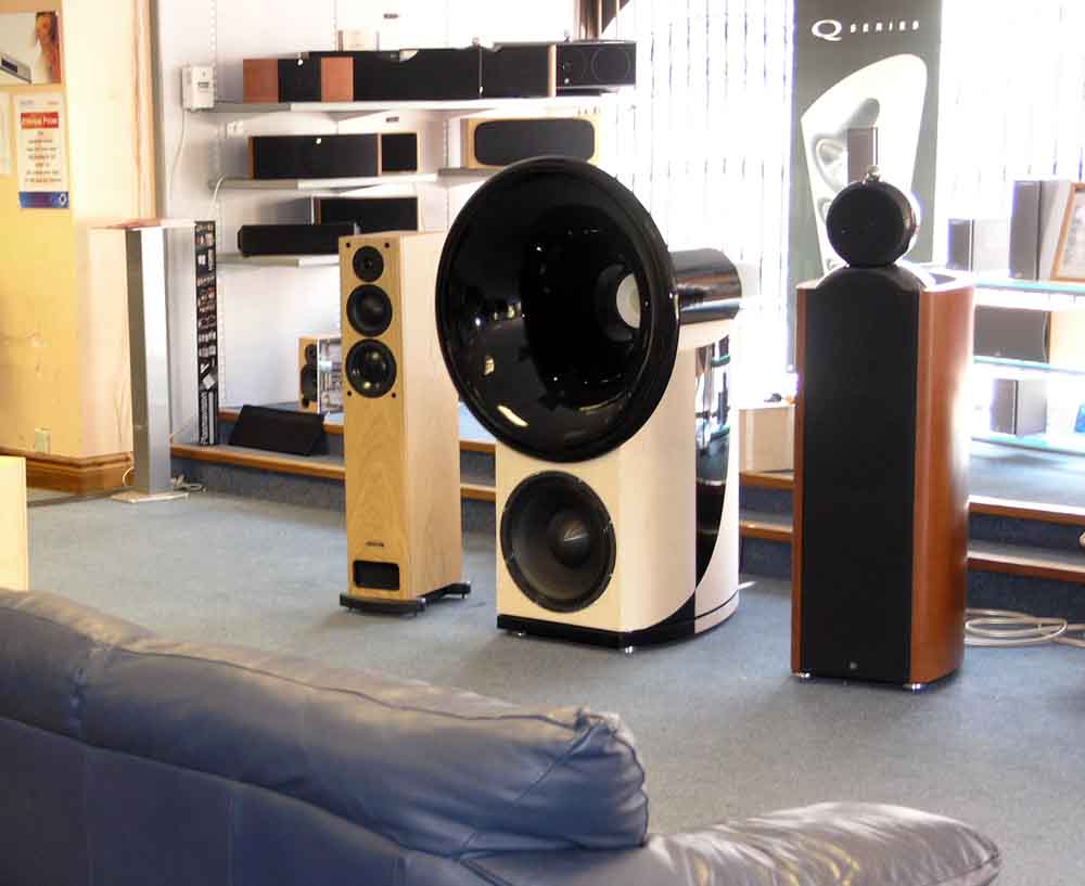

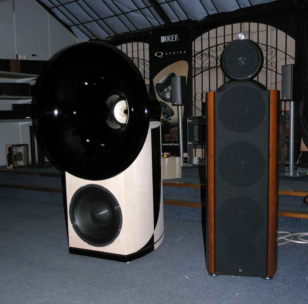

Went to Sevenoaks HiFi in Peterborough yesturday with the completely finished one to get an idea what people think. Attached is a picture at the shop with my speaker next to a Kef Reference 207 and a PMC OB1 - Please please let me know what you think, positive or negative, its really valuable to me for evaluation purposes.
Cheers, Richard.

Stunning! Just in case I missed something and this is unfinished bass cabinet, the color does not work at all as is IMO with that attractive glossy pattern overlay. Needs to be red or blue, maybe orange or yellow as in hi-gloss shiney sports car colors IMO.
Have you thought about a dressy protector screen or other to protect the vulnerable woofer?
Again, very nice!
apart from the shiney black bits, the cabinet is veneered in a very high quality maple veneer, rich has done a great job. The photos really do not do them justice and they look great in real life, i think that having the whole thing painted- especially a bright colour, wouldnt work in real life. They are big enough as it is, the veneer helps them be a bit more subtle (if a huge great front horn can ever be subtle . . .) and a bright colour would be overkill i think.
As far as i know the woofer will get a grill and the horn will get a kind of "sock" that fits over the end made of stretchy grill cloth. The exposed woofer looks very cool though with the massive phase plug. :)
