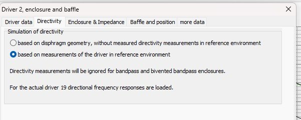

Hi @stv , appreciate your feedback.The issue here is that measurements on a standardized baffle are mostly useless if your speaker has a different shape. And while VituixCad offers a (simplified) diffraction simulation I am not sure it can be precise enough to justify 5° measurement steps.
If I am not mistaken Boxsim just uses a flat piston diaphragm model to simulate directivity.
BoxSim introduced a new drive unit measurement format a couple of yearss ago, where they replaced the piston model with a set of measurements from 0 to +/- 90 degree with 5 degree steps, but only for their own drive units
