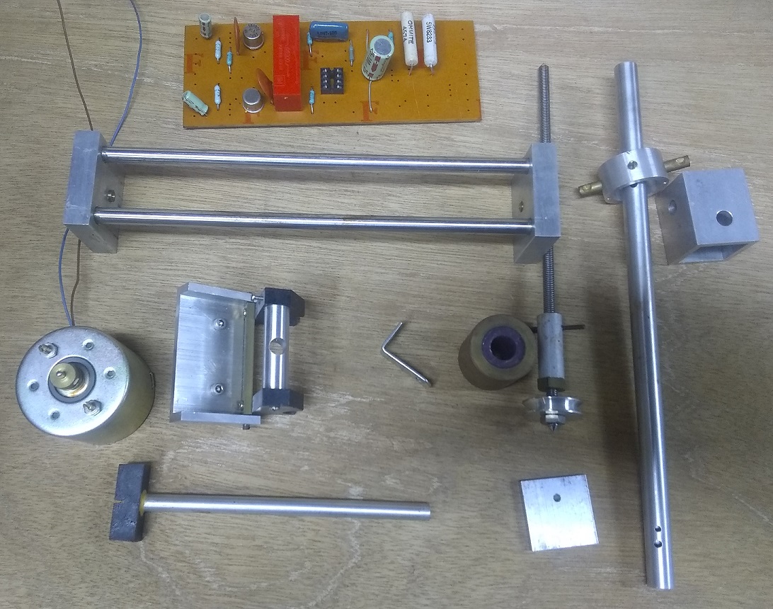

From AA 4/82 "A Tangential Tracking Tone Arm" Kit
This kit tone arm was published in Audio Amateur 4/82 and I got one in a trade
still in the box. I'm wondering if anyone has built it, seen it work, or heard
anything good/bad about it?
I looked over the documentation and remember reading the article when it came out.
What I like about it is that it has a pivot like a normal arm but with photo sensors for
when it goes even slightly off linear which are used to ramp up or down the servo
speed. This way if the servo fails it just works like a normal arm but with the usual
tracking error, the bearing also, sort of decouples the arm from the servo movement.
Clever, I like that aspect.
I have not assembled it as I was asking to determine if it is worth the time.
Here's the picture:

Yes, I do. I fell for this same post over on another forum. I scanned and posted the entire aa 4/82 construction article in response, with nary a comment or thank you.
Looks like the moderator(s) over there took the thread down.
Ray K
Thank you, have you built it?
Nope. At the time it was published, I already had 2 Rabco tangent trackers that worked fine, so had no need.
Just happen to have every issue of TAA, so when someone is looking for an article, I'll try to oblige.
It's an intriguing design though, servo that runs at nominal groove pitch so no major dithering, and the unusual optical trigger method.
You're the guinea pig🙂. Get 'er built! Let us know how it works!

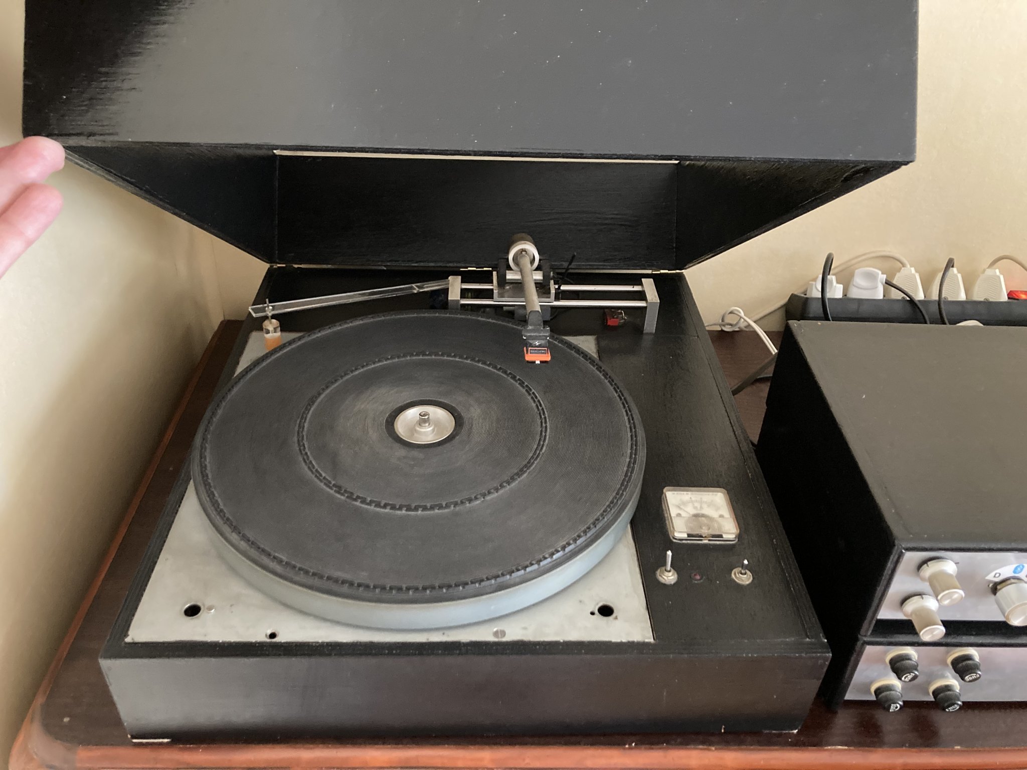

I realize this is a bit late but I just found your question. I built this arm in about 1980 and it’s been working perfectly ever since! I attach a recent photo
Reactions: tonealone and PRR
