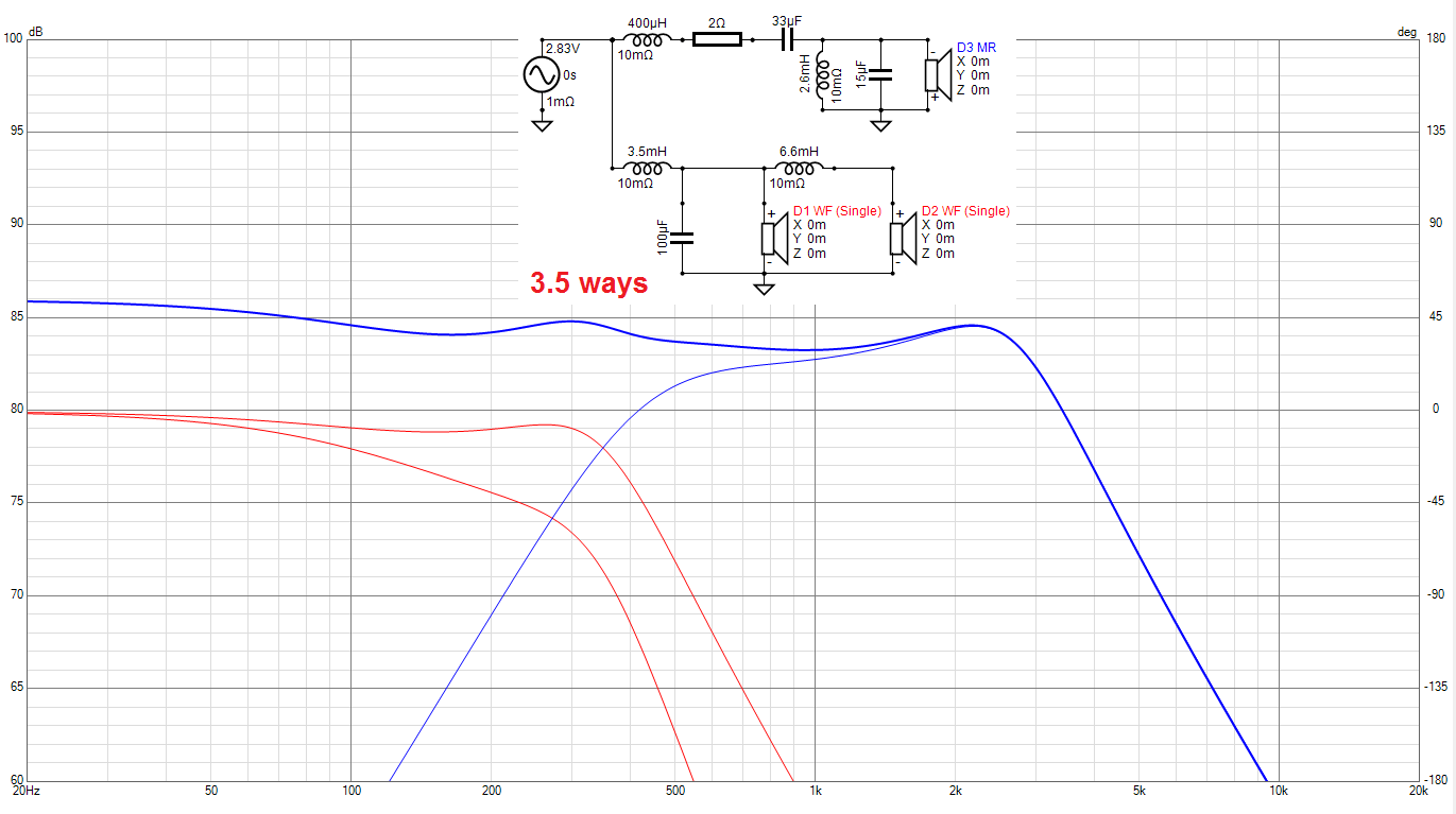

I finally decided to go for the 3.5 ways conversion.
Previously, I played with tweaking the 3 ways and found that the sound from the woofers was the most favourable when the woofers were limited to play below 300Hz. However, the problem was the 2" dome midrange couldn't go any lower, otherwise, a huge gap between drivers would be generated. Still, there's a condition that the woofers would no longer be allowed to play above 300Hz. Therefore, the system need to be fulfilled the gap between woofers and midrange.
To go for 3.5 ways, I've played with simulation on VituixCAD simulator. I experimented by adding a first order inductor to the lower woofer but without changing the original component values. Attached are the results.
Here is the question, is there anything more complicated to be concerned than adding a large inductor to the lower woofers?
