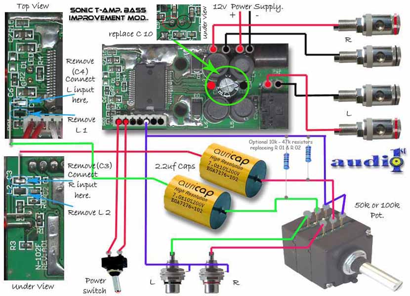

I decided to mod my T-amp following the steath mod as pictured here. Only problem was, when I modded the amp I accidently removed L3 from the board. I managed to keep the tiny surface mount component, and solder it back on as best I could (it was tricky!)
The other mistake I may of made was instead of bridging C3 and C4 I removed them from the board and bridged them on the PCB, again this was pretty tricky work and looking back I realised maybe what was suggested was that I keep the surface mount caps on the board and simply solder across to short them.
The input caps I am using are basic caps available from Jaycar electronics (see here
- are they ok? The idea was I would at least get the mod to work, then maybe experiment with better caps.
The only thing I did which was different from the stealth mod was bypass the pot completely as I am using a preamp. I did this by connecting the input caps directly to the RCA jacks that I am using.
ANYWAY - I hook it all up with new speaker terminals, power switch and case, and when I turn it on all I get is a hum, both channels. Power supply is connected the right way around.
I check the C3 and C4 bypasses, and carefully resolder C3 - it perhaps wasnt bridging the PCB pads properly. I now get no hum, but no amplified signal either.
I then decide to reinstate the wiring for the Pot, thinking that my bypass may be the reason why it isnt working, still no joy.
I am not sure what I have done wrong! I am thinking I may of somehow fried the T-amp, and I may need to get a new one
but maybe not?

I'm no EE but I think you need a bridge to ground on your signal wires. Did you remove R01/02?
From what I've been told the resistors to ground need to be in front of the new capacitors so remove R01/02 and put in a 50K bridge on each signal wire before the caps (not after them).
(The pot usually creates the bridge on the stealth mod)
Again, I'm no expert but I have done a few of these babies and I think this will work.

Hello Kaban, sorry to hear that you are haveing problems with your T Amp (lots of us have been there!).
Don't give up on it just yet, you still have a couple more opions. Without haveing to replace any of the tricky surface mounts you have already removed, you can try the following:
The first route is to remove L1 and L2 (I think you already had trouble with L2?). Then connect as per the diagram below with the new 47k resistors as shown,( as mentioned by Lee), if you intend to remove the Pot.
If this fails you can still try the Classic Mod shown here even with R01, R02, L1, L2, C3 and C4 removed!
Are these Amps a blessing or a curse? (yes they are GREAT when it all works!)
PS make sure you have a good grd from the phonos to the board and that your speaker terminals are not makeing contact with the case (if metal?). Good Luck.....

It's fried
I tried what you suggested, but I think I have fried it. I think perhaps a careless solder join shorted out some part of it, at one stage it gave a puff of smoke. I can't believe it because I did work really carefully. I knocked the L1 surface mount and then tried to fix it, so I am thinking this is where I went wrong. Anyway, now it is no longer working in any capacity, so I have ordered a new T-amp and will try again! 😀
I am totally mad, but hey, it's all a learning experience! Next time I will be more gentle with the surface mounts and really take my time.
