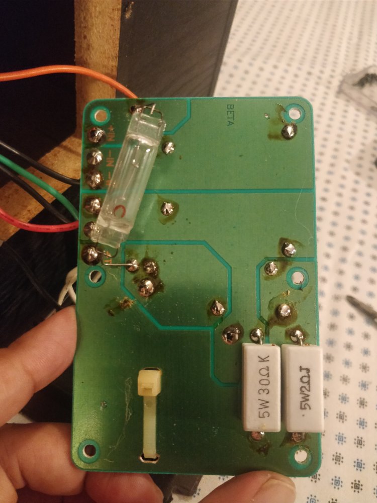

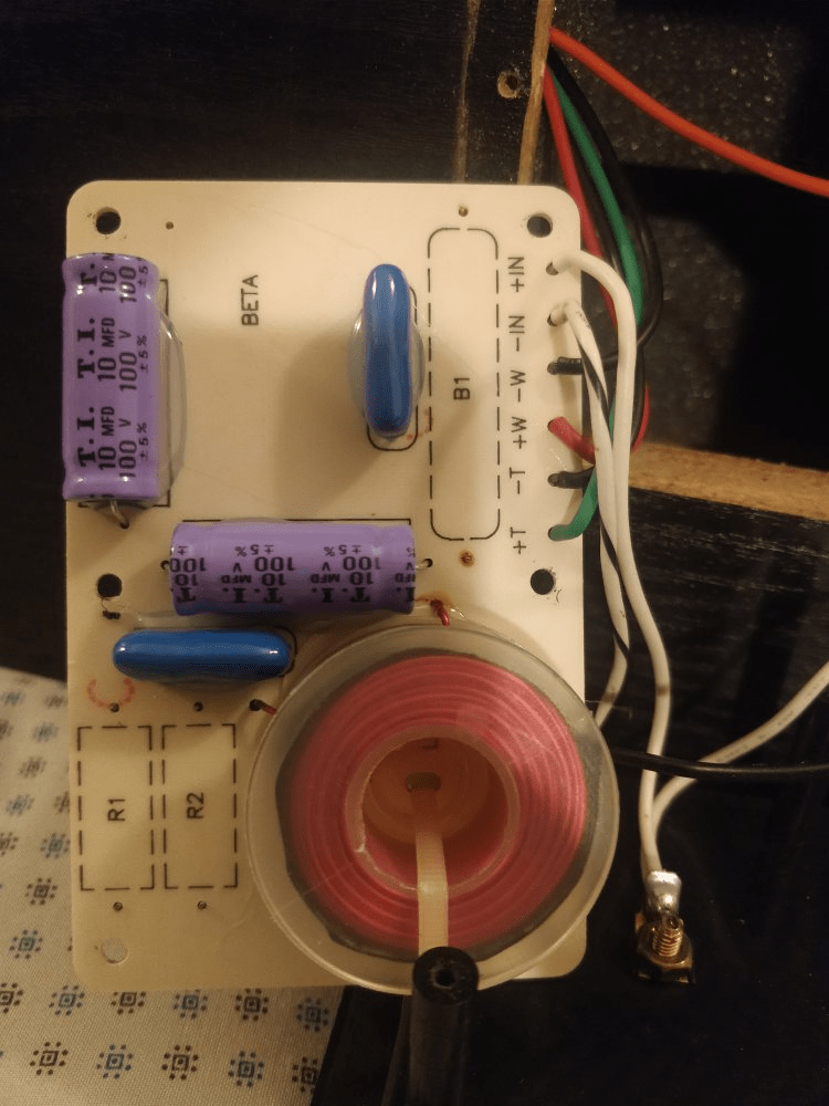

Opened up the Crossover and found the below - it's supposed to be a SERIES Crossover (not parallel)
These are 23-24 year old speakers.
I would first duplicate the connection cable.
Bypass the connectors if you cannot find/get them.
If it works then, fine.
If not, you will have to test the components in the crossovers,
If marked, see if they are within tolerance. If not, compare to mate from 'good'.
Be systematic, take notes, you will get there. It will be worth it.

1. I Duplicated the connection cable today.
One speakers' smaller MARS hole connected to the other speakers Larger MARS hole. And vice versa.
Did not perfectly CORRECT the sound of the malfunctioning speaker.
2. However, I started listening to the malfunctioning speaker's tweeter more closely....and it seems that it is what is causing the offense.
3. I spoke with David Ellis of Ellis audio in Minnesota - he has been dealing with Fried speakers and the Hiquphon Drivers since 20-25 years. His recommendation was to test, in this order
http://www.ellisaudio.com/
a. Drivers' resistances
b. Capacitors and Crossover
c. MARS connections.
If you have a defective driver in a series crossover, it will mess with the other driver a bit.
David is also a reliable supplier of those tweeters, if you lack a local one. Dome/VC may be available from hiquphon or their distributors.

Given that these speakers have not been played MUCH over the past 13 years, I suspect that the bulb may be fused in the back of the Crossover Circuit board.
