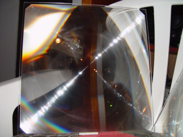

anyways heres some pictures of the ones i have for sale

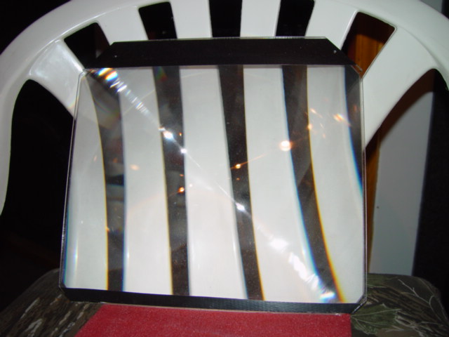

I will also sell my diy labs fresnel for the same price
wich has these specs
12.25x12.25 overall
the active area is 11 7/8"x11 7/8"
2 glued together
bottom one has a fl of 14"
and the top is also 14"
and rember this fresnel will not light up the entire 15" lcd
but if you can adjust the horizontal size it will work with out cuting
the corners
heres a pic of it i taped off the area the lcd wouldnt cover and cut
some of the one side to make my encloser smaller but it does not afect anything
