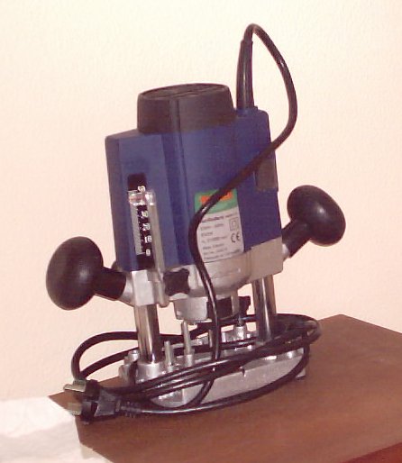

Heya JX, here is a pic of my router, they are high speed and dangerous if you dont know what ya doin, but very easy to use, and give very precise cuts, practise makes perfect.🙂
In my books its a projector must, the things you can do with these machines is amazing, you can basicaly do any shape from templates and make very respectable projector boxes with perfectly rounded corners.

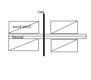

Hey guys I decided I am going to try it with a saw but i don't get what you mean by use a towel. What if I just use tape to avoid scratching it I mean just tape where I goiing to cut would that work better.
make sure you have a cloth down to slide fresnel on so it does not get scratched, i have actually cut fresnels with a table saw, the blade turn fast enough as not to crack or break the fresnel. but what ever or which ever way you do it take care to protect the frenels from scratches.
