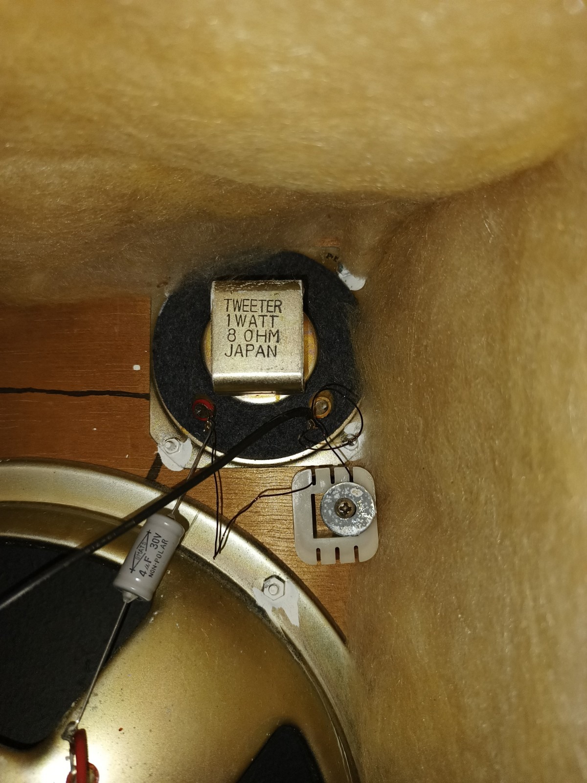

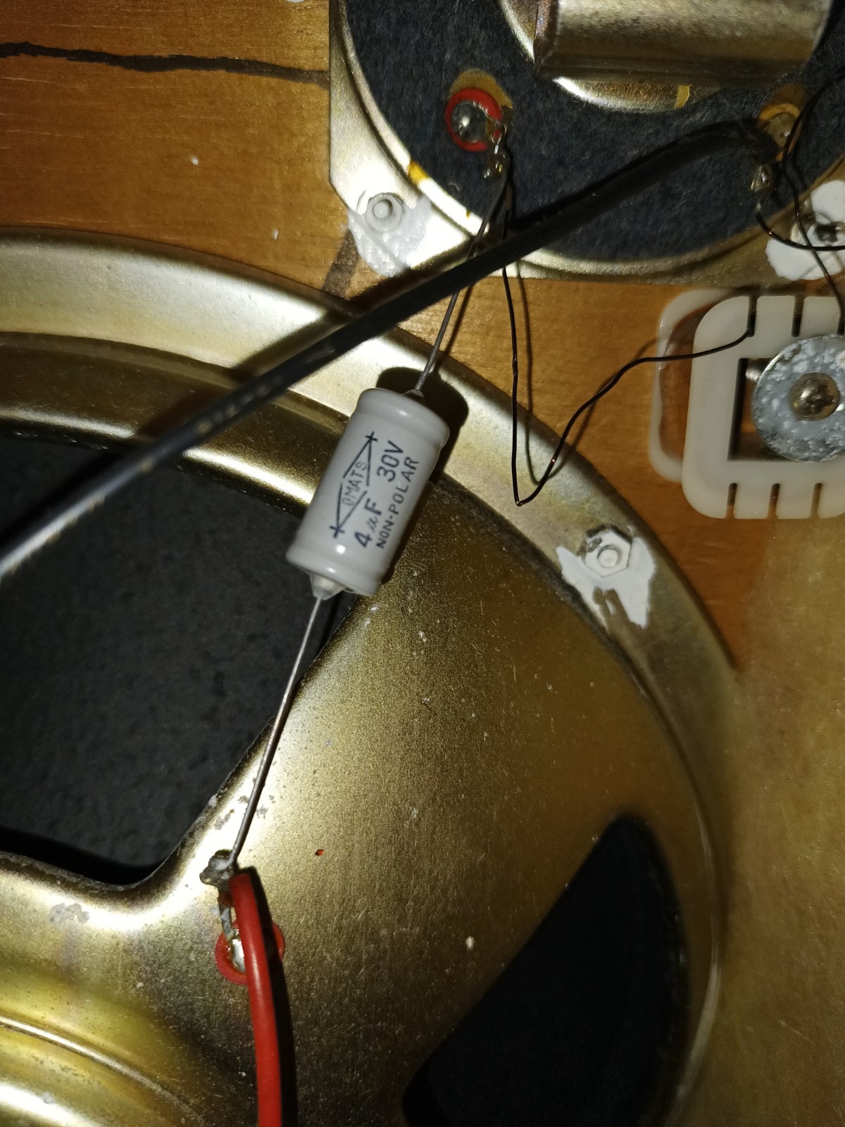

I refitted the parallel Caps this morning.
Now 2 x 2μF Caps in parallel per box in place of the old 4μF caps.
Ran a track.
Very pleasing to listen to, more depth, and nothing obviously harsh.
Perhaps on the boxy sound but this is down to the large enclosures.
Thanks for your input & parts. 👍

Now restored to 4μF per box.
It didn't want these to fall in my already large pile of partially completed projects.
Also placed foam strips inplace to seal the mating surfaces between the boxes & rear removable panel.
