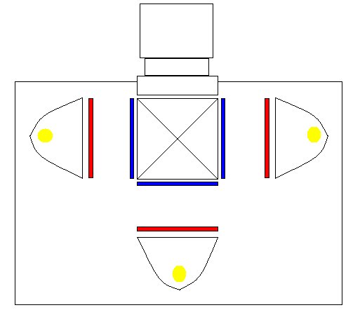

Dear Diy-crew,
I've been playing with this idea for a while now and now I think I should share.
Everyone here wants to build a lcd projector but small hi-rez inexpensive lcds are hard to come by and 15" are hard to work with so my idea revolves around the 5" lcds from partsexpress (set to display in "BLACK - WHITE". However, my idea calls for 3 of them (represented in blue). Then 3 light sources, of course one is green one blue and one red (run through colored filters. These can be regular (hi wattage) HI bulbs (100-150W) and three small index card size fresnels (for obvious reasons).
The only problem I see here is the prizm. It has to be at least the same size as the lcds. A prizm is nothing more than 4 triagle pieces of glass put together (represented as a box with an X in it). I imagine it could be found or ordered from a glass shop??
If all three lcd & lamp fixtures are built exactly the same i would imagine it would be easy to align. And with 3 lcds you get 3 times the resolution. This is the same way commercial projectors work.

The prisms as shown in your diagram won't work, but you are getting closer to a good design.
Here's a few of the points of inefficiency:
Filtering light turns light into heat. Best case, a white light going through a red filter will waste the green and blue light.
So, overall, you will have 2/3 of your light wasted, right at the source. (All 3 source will each waste 2/3 of their light).
Passing red light through a color LCD set to B/W is going to waste another 2/3 of your light, because only 1/3 of the pixels will pass the red light through. The blue and green pixels will not pass your red light. (All 3 LCD's will each waste 2/3 of their light).
If you could get true monochrome LCD panels (that don't have any colored filters) and feed them just one signal (like one LCD gets just the 'red' signal), then you could add them up like this.
If you could remove the color filters from a color LCD and send it just one color signal to all three inputs, that would work as well.
Look at your design and try to replace filters with dichroic mirrors (or a prism, even) to seperate the light into the desired colors, rather than filtering.
You can also use these mirrors to re-assemble the light from the 3 LCD's prior to going out to the screen, via the objective lens.

Apo,
Sounds like your prism arrangement is actually an X-Cube, a very special type of collection of prisms.
These are used in commercial projectors to re-combine component color signals as you are explaining. They can also be used for separation.
They rely for their magic on special ultra thin coatings and are basically dichroic mirrors slapped onto prisms.
Take a look at this:
http://www.us.schott.com/english/applications/digitalprojection/opticalengine/xcubes.html
Is this what you are seeing in you commercial projector?

neededandwanted, that is exactly the prism in my projector. It would work for this idea i think. what is the cost of one of these cubes?
No idea about the cost on one of these. The manufacturer will likely sell them in lots of 10,000 to start. They will usually make an eval kit available, that will either be cheap, or free, or expensive. By this, I mean that they price the eval kits out of the range of the DIY crowd (a DLP eval kit with a single panel runs $10,000 USD from TI) but will give them to big companies. Basically, they send samples and kits to the big companies and labs that they know of already. Typically, they also send along an invoice for the big bucks, but never expect it to be paid. They also send out samples where the lab promises to retun them after 6 months (again not expecting to get them back.)
As with all DIY parts, the game is to go hunting.
