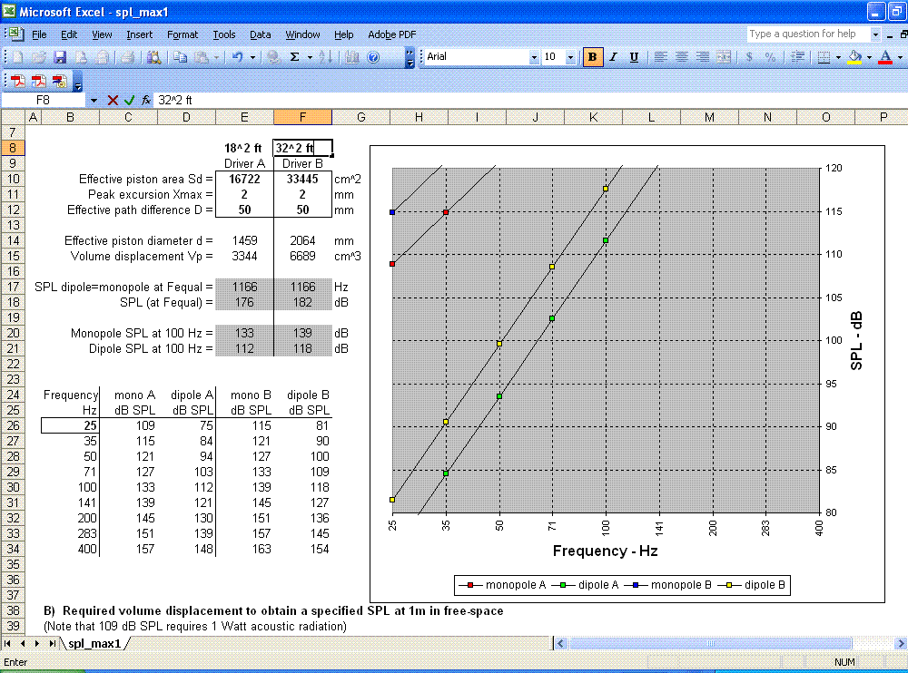

The 32nd of an inch spacing is about the maximum that can be pulled off. My great master plan is to make a apeaker with three 24" x 36" panels each. It should give me a decent amount of surface area. About 18'^2 each side. I'm going to punch this into the Linkwitz dipole calculator and see what and where the low end roll off will start. Below the low frequency suckout I will be transfering the real work to horns. Still a clean sound.

I puncha Dah numbers and this is what I got
Her is the big number crunch. Dipole driver A is the 18'^2 single panel. And Dipole driver B is the two together. There will be room gain as the frequency goes below about 60hz of around 12db/octave. So all in all this is fairly respectable. That's if I used the correct info 🙂
Mark
