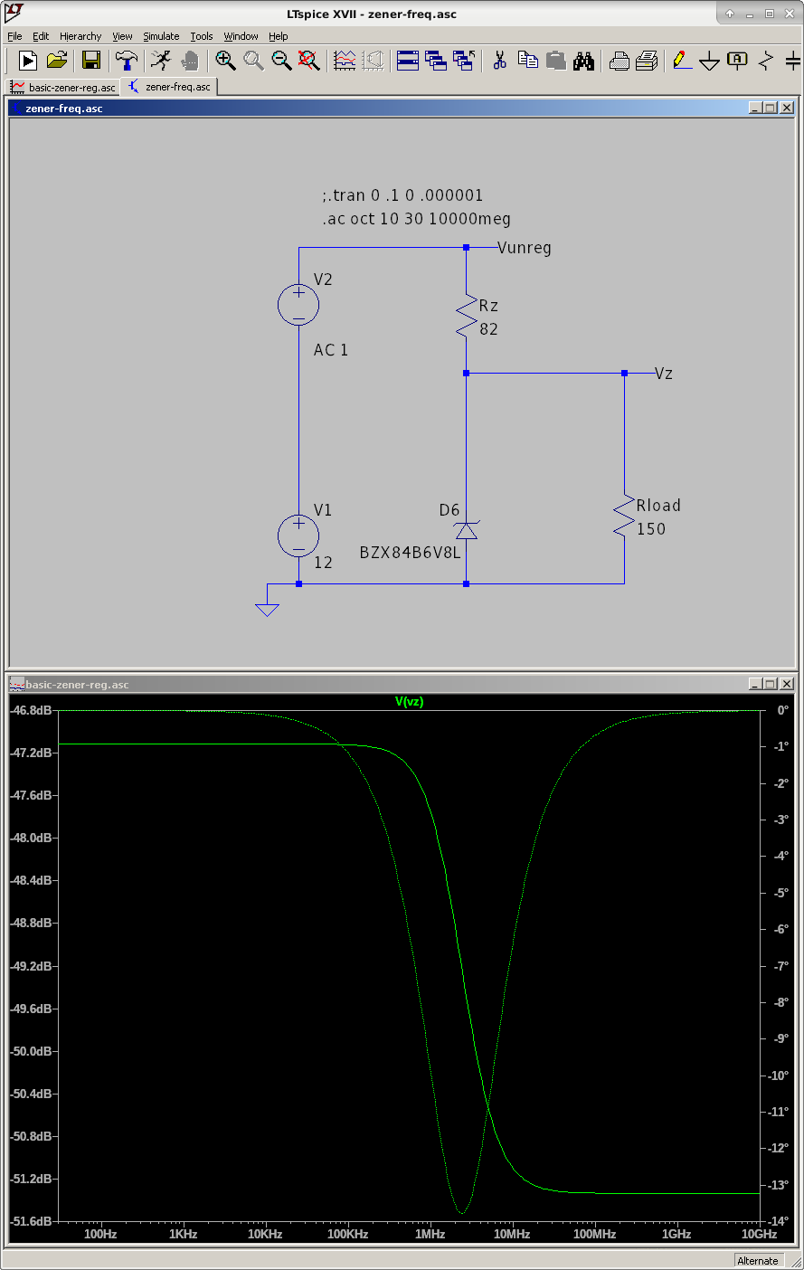

Hey guys, just wanted to sanity-check that I'm using LTspice correctly.
I wanted to see what the frequency response of a basic zener diode shunt regulator looked like (see screenshot 1).
I was surprised that the drop off was only about 4db, then plateaued? This can't be right -- a zener only loses 4db of regulation out to 10GHz?

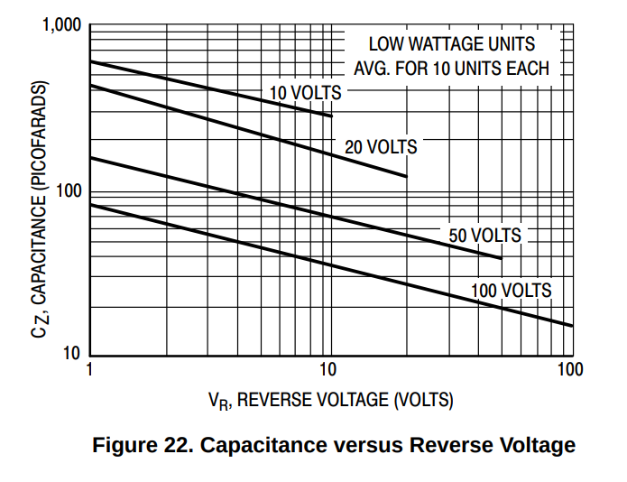

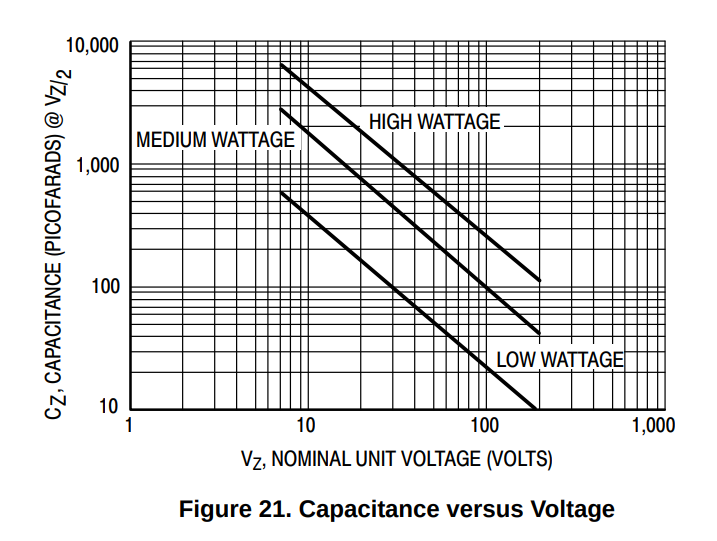

I looked through the On-Semi "Zener Theory and Design Considerations: https://www.onsemi.com/pub/Collateral/HBD854-D.PDF

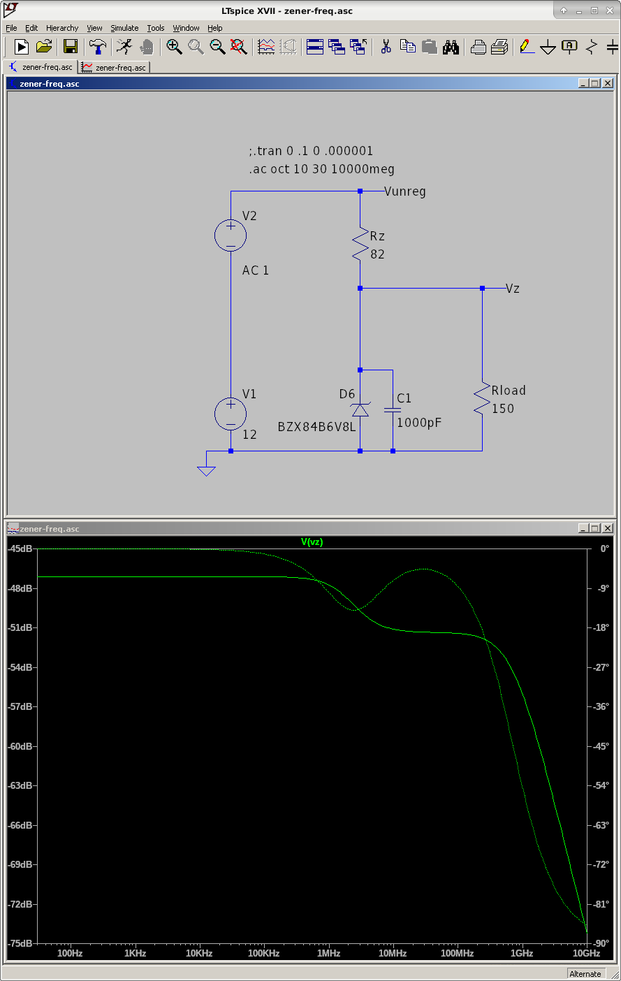

They seem to indicate a simple 1/2 watt low voltage zener's capacitance would be under 1000pF, so I placed a capacitor in parallel and simulated that as well (see screenshot 2). This produced a more expected result -- there is a rolloff which doesn't stop at just 4db.
This second simulation seems to indicate a basic shunt regulator should still be in regulation out to 100MHz. Is this realistic?

One thing to be careful of is that parasitics such as capacitance across the diode junction varying with the voltage across it may not be modeled realistically out to such high frequencies. Stray inductances and capacitances elsewhere in the circuit will affect what you get in real life at those frequencies as well, and the model won't show that unless you can include them in it.
To begin with, you ar feeding it throughb meager 82 ohm resistance.
To boot, equivalent capacitance will be shunted by zener diode internal impedance, which by definition is VERY low.
Or it wouldn´t be a voltage regulator/stabilizer.
Combine both and I can see capacitance being a minuscule factor.
Also capacitance is not the same when not "zeneing" (no avalanche reached so it´s basically "a regular diode") than when it is.
The max Rz is 15 ohms, and the 82 ohms with the 150 ohms load represent an equivalent source R of about 50 ohms. So the best you can expect is 15/50 is about 10dB suppression.
The max 15 ohms is in the data sheet, who knows what's in the spice model. You could check that.
Replace the 82 ohms with a current source and Bob's your uncle.
Also that 150 ohms needs to go or to be increased a lot. Why is it there?

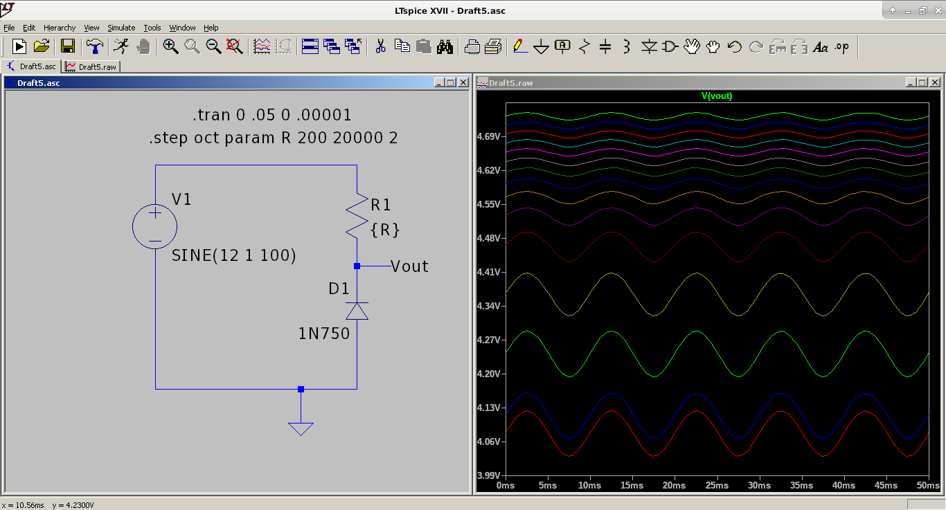

Thanks jan, when you say "series R" and "zener R", which refers to which? Is "zener R" the series current-limiting resistor ("Rz" in post #1), or does "zener R" refer to the dynamic impedance of the zener?
Here is a simulation which seems to indicate that higher zener current is what improves regulation (see screenshot, lower resistance values are near the top of the graph).
