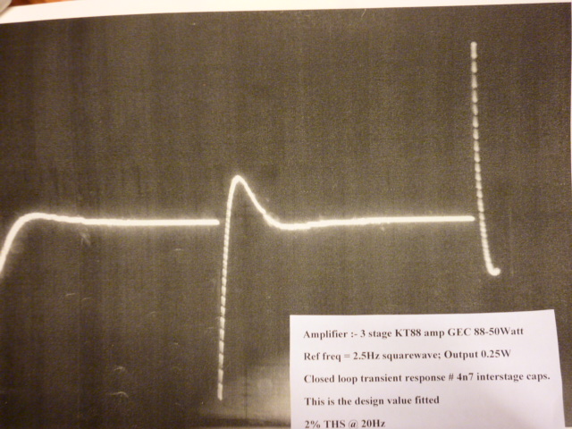

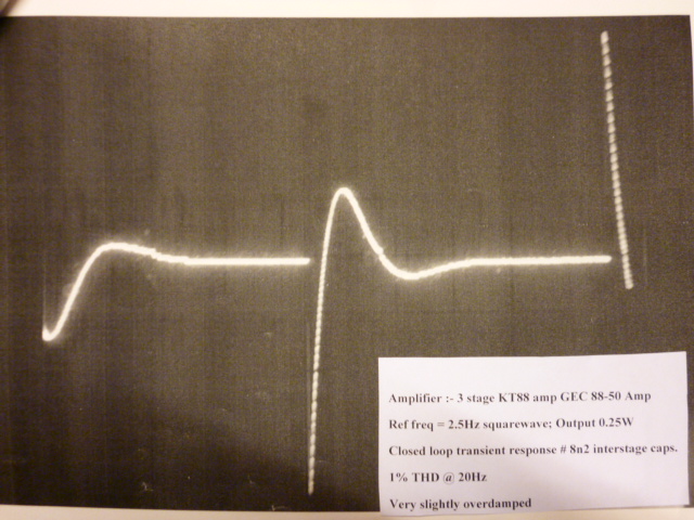

One has to do the closed Loop transient analysis at 1Hz square wave at very low level, 1/2W or less at the output;, no more as o/p tranny will saturate. What one is doing is to assess the closed loop droop, as if the interstage coupling capacitors are too high value (as per original Williamson) the circuit gain with the output transformer in circuit is on the cusp of being in LF oscillation. The cure is to reduce the interstage capacitor values from the phasesplitter outputs. I am not sure SPICE can simulate this, try by reducing the values and the frequency and see what happens.
I have the development analogue stuff on another stick and will have to dig it out.
The secret to to examine the very low frequency "Q" of the waveform on the output as it has time to settle from one cycle,. hence a high persistent scope of storage scope is vital to view the full details. I always aim for a Q of about 1, this culminates a three/four stage Williamson with generalised 25dB global nfb, then running into oscillation when the global feedback components are decreased, i.e another 10dB will create instability.
This may appear mighty technical to many but I am quite sure once this is mastered, nirvana in building amps for stability is obtained. Then the emphasis is the upper end, but I tend to avoid describing that as the unpredictability of layout can be quite a nuisance.
Hope this helps.

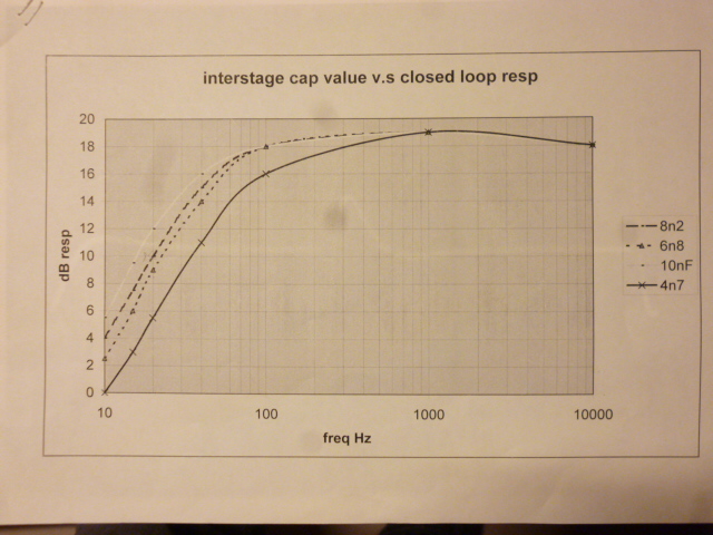

Here are some quite old pics of the work I did in 1965 and the open loop vs cap values more recent. Note these are for the 3 stage 1955 KT88-50 amp which was an excellent performer despite using a self balancing paraphase inverter.
When interpreting these pics, note the THD decreases as the interstage cap value is increased but the transient Q also worsens. It makes sense as "the payoff" of the optimum damping has to be increased distortion, as the value of the interstage cap pertains to the amount of closed loop feedback handled at the LF end.
Each and every designed amp will exhibit these features.
The optimum findings also coincide with Steinmetz's law; that with the standard iron used at that time, the 1.4% F2 thd is the figure obtained at the cutoff frequency and excitation design frequency of the transformer...the result that many output transformers produced of that era, and even now.
It will become obvious to seasoned designers that amplifiers exhibiting a good closed loop response will behave and settle better on fast rising signal transients, sound better and less muddled..
Big cap values certainly don't imply good bass response ! Conversely, too small value interstage caps certainly will sound thinner.
richy

The KT88-50 paraphase circuit operates at higher impedances when compared to true Williamson with buffer driver. For those who wish to replicate what I've done, must take into account all R/C time constants around the relevant circuits otherwise one will get nowhere.
Your difference between 220nF to 250nF isn't much. I did all my work with ratio min twice between values. To get results I would have started with at least half, i.e 100nF.
First, I do the open loop response (without gnfb) and must be plotted. For others starting out with the physics of closed loop design must realise that when global nfb is connected, the circuit will correct the response to a flat one but the value of the interstage caps and relevant resistors will determine when the loop gain runs out.
