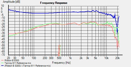

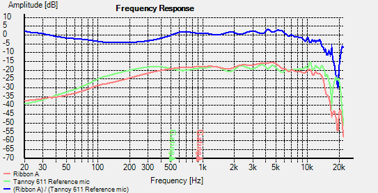

A friend brought around a pair of these mics and below are the graphs.
Berhinger reference mic using Tannoy 611 as the sound source.
My friend tells me that these microphones were not as bought from Studio Spares, but had been gutted and the Mic transformers replaced with bespoke Ribbon transformers because of the unacceptable base noise level from the FET input.
But clearly they're a good starter for modification in such a way.
