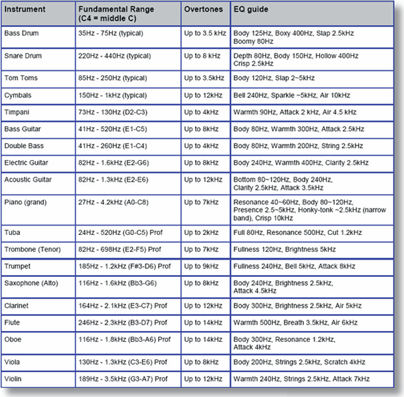

trying to attach a chart showing several musical instruments and their overtones...let's see if it shows up...
Any instrument involving one thing hitting another will show a large series of overtones, right up to ultrasonic.
The kick drum one is particularly inaccurate. Even Shure's Beta-52a reaches higher than 3.5kHz.
I stand by my previous post, that the 400,000 rule has so many holes as to render it useless.

40HZ yes, but on a lot of music, especially vinyl, I see notable content up to 10K, then not much above that. So 8K might be selling yourself a little short. Cutting off at 7K definitely takes warmth away from the strings.
Agree!
I have seen better charts and graphs showing harmonic and overtones of common musical instruments. I'll see if I can find some better ones today. Even an electric bass can have rich overtones well past 7 KHz. Violins, violas, etc. go WAY past 10 KHz, electric guitars can really have very rich overtones as well.
What is the highest note on a piano? Almost 4200 Hz; as it is not a pure sine wave; harmonics, overtones, etc. reach well above this.

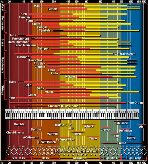

Tech Stuff - Frequency Ranges
Still not the exact one; I'll keep looking. This does have good info though.
https://cms-assets.tutsplus.com/uploads/users/1170/posts/25651/image/main_chart-610x677.jpg
see if this opens; I'll also try to do the attachment with the paper clip icon...
