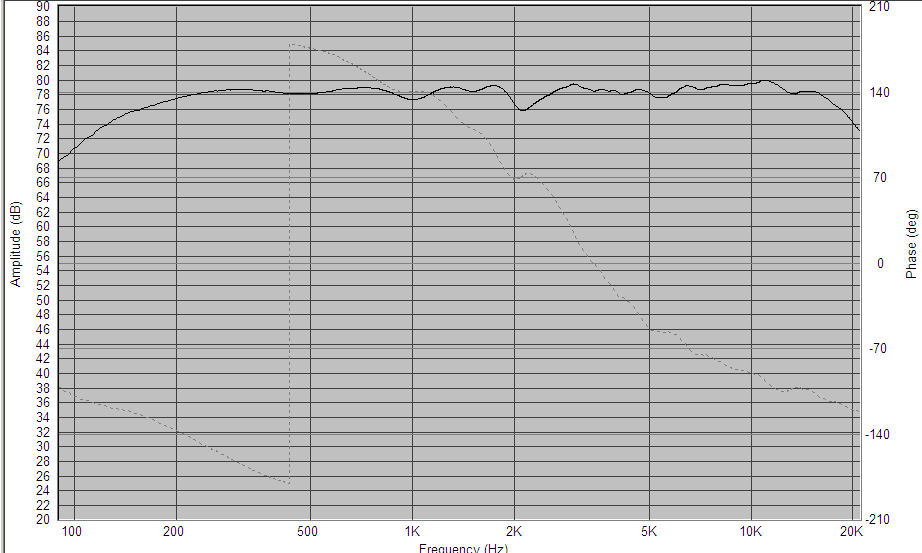

But I have a question regarding frequency response.
In his specs he has mentioned frequency response to range from ±3 dB " 120hz - 27khz "
Considering the low frequency I want to ask that does this above stated figure means that these towers wont be able to produce low end sounds below 120hz? Normally the tower speakers I see in market usually have a Frequency range as low as 40Hz. I am a little confused with his specs.
Can someone on the forum clear my thoughts on this?
By the specs he has provided, does it means his towers will produce just the mid bass? and No Sub-bass? I dont like to hear the boomy bass at all. Will his towers sound boomy? or has he provided / calculated the Frequency response of his speakers wrongly?
Can someone calculate and tell me What would be the frequency response at ± 6dB?

Ask to see the actual frequency response curve that the specs were derived from. This will tell you more. It may in fact have a hump in the bass in that is more than +3db just below 120Hz and then starts to drop off, it may also be -3db and dropping at 120Hz (though if it is using 6.5" drivers this seems extremely unlikely).
See the attached graph for a visual example.
If you take the average point as being 78db then the speaker is +- 2db from approx 150Hz to 18Khz.
Note that this was a gated measurement and below about 250hz is meaningless, the speaker is in reality around 3db down at 80 Hz.
Tony.
