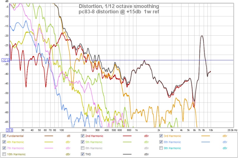

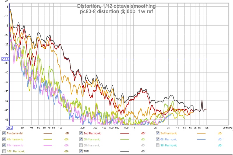

So far we looked at the low power end, going -40db ref 1w input. It was an interesting question and I posted some data for one driver in post #16.
Lets go the other way, the high end of the power range. This particular speaker (pc83-8) has a Pmax of around 30w. I'm willing to post some graphs on this. Lets see what i get, as speaker SPL rises by 3db for each doubling in power, and in a LA it rises by 3db for each doubling of drivers.
Single driver, power increases:
1w -> 85db
2w -> 88db
4w -> 91db
8w -> 94db
16w -> 97db
32w -> 100db
So I can safely measure distortion up to +15db ref 1W , for a single speaker.

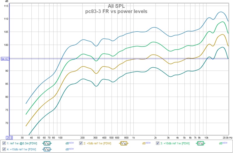

Now for another question: Since the frequency response graph of the same speaker varies from speaker to speaker(by a little amount or a big amount depending on the quality of the speaker), would it be possible to say that in a line array of of 40 speakers that it produces as a group a kind of smoothing of the whole response, much like a 1/24 smoothing? And if it doesn’t do this, what does it do, strictly from the standpoint of listening?
Is it possible to measure something like this by moving the measurement out from 1 meter to maybe 3 meters?
... distortion increases (at least for the pc83-8)
The FR shape seems to stay the same but the distortion increases. The levels were adjusted at the amp and the soundcard, and the mic needed to be placed at 0.1m to get a reasonable signal at -40db from the 1W reference. The increasing distortion is trending at intermediate stages as well.
