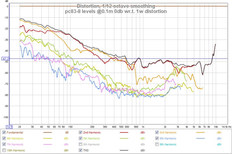

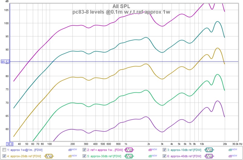

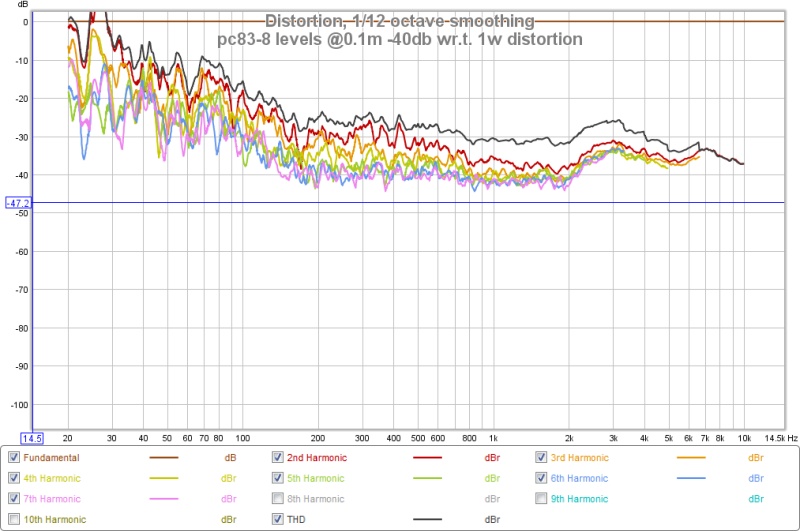

... distortion increases (at least for the pc83-8)
The FR shape seems to stay the same but the distortion increases. The levels were adjusted at the amp and the soundcard, and the mic needed to be placed at 0.1m to get a reasonable signal at -40db from the 1W reference. The increasing distortion is trending at intermediate stages as well.
Interestingly, distortions aren't always linear, they can rise as excursion decreases, have a look at some of the distortion measurements Linkwitz took.
