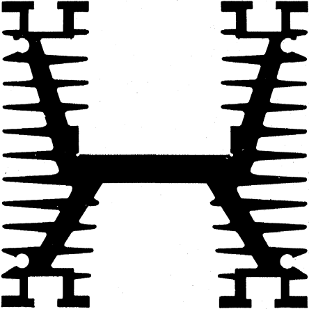

Wow them are big. Odd design though. The fin thickness is the same at the root as it is at the free end. If you got a couple hundred CFM through one of those, the ends would fall to ambient even if 500 watts were dumped into it. They look cool as hell, but thermodynamically not optimum (from a sink volume per max dissipation perspective). They may be optimized for a quite moderate forced flow or chimney. Plain convection would be OK, more reasonable if they were cut in half height-wise, since at very low flow the upper half of the sink (at 290mm) is going to be bathed in already heated air.
Anyway, they will be just fine for your project.
Just an example
The nature of the heatsink is that it will not be very good at dissipating point loads due to the thin fins and the even thickness of the base.
You will need to help it along by spreading the heat sources across the heatsink.
If you calculate the actual area of each fin with all the fins it will be better than 0.5 Deg C/Watt. However, as the fins are very thin at their bases the heat will not travel up the fins very well.
The ideal Heatsink should have thick roots and thinner tips.

Yes I noticed that directly when I got them that the thickness of the fins are even and I thought that doesn't matter, but now when you are saying it makes perfect sense that they are not optional.
Well I think I'll go on and give them a try. If they overheat then I know not to use sinks like these. Who lives shall see.
