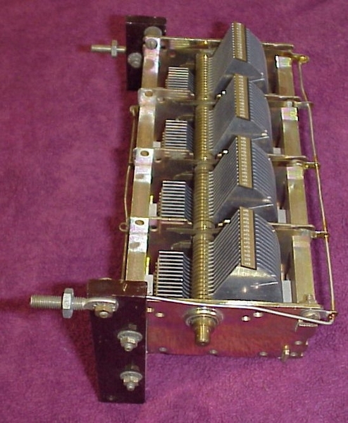

The mechanical solution would be probably too "expansive" 😉
