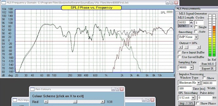

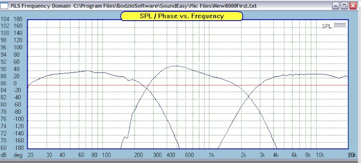

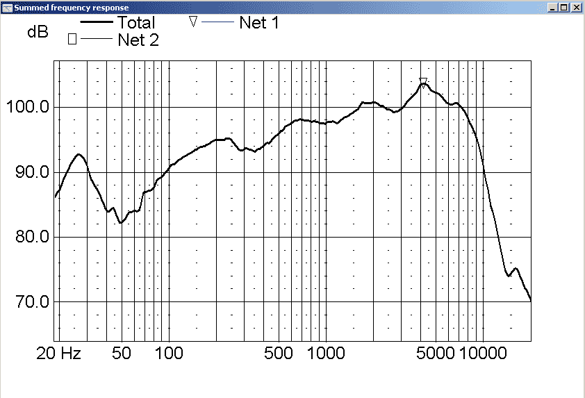

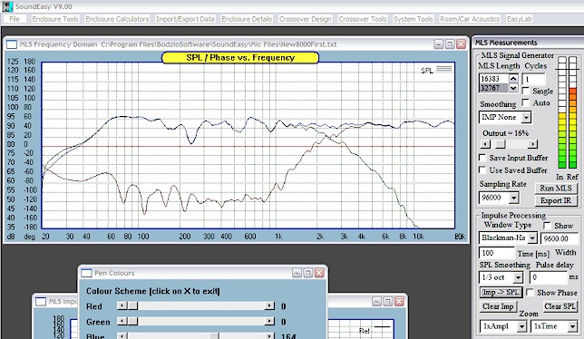

- Freq Response Measurements of PHL drivers
