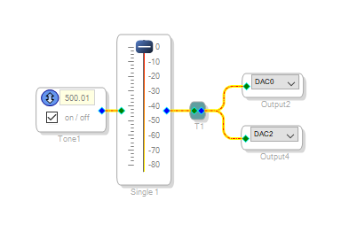

Hello, I have exactly the same problem. DAC0 and DAC1 work fine, but DAC2 and DAC3 are extremly noisy. Its a white noise and it is not from ADC (as DAC0&1 work fine). Tried 4 different power supply, USB from PC, 9V power brick, 5V from power bank and 15V PS with 7815 stabilizer. All work more or less the same, there are only subtle differences between them.
I made a project in sigma studio to generate 500Hz tone, that I fed to my ESI Juli@ sound card and analyzed it with REW, results bellow.

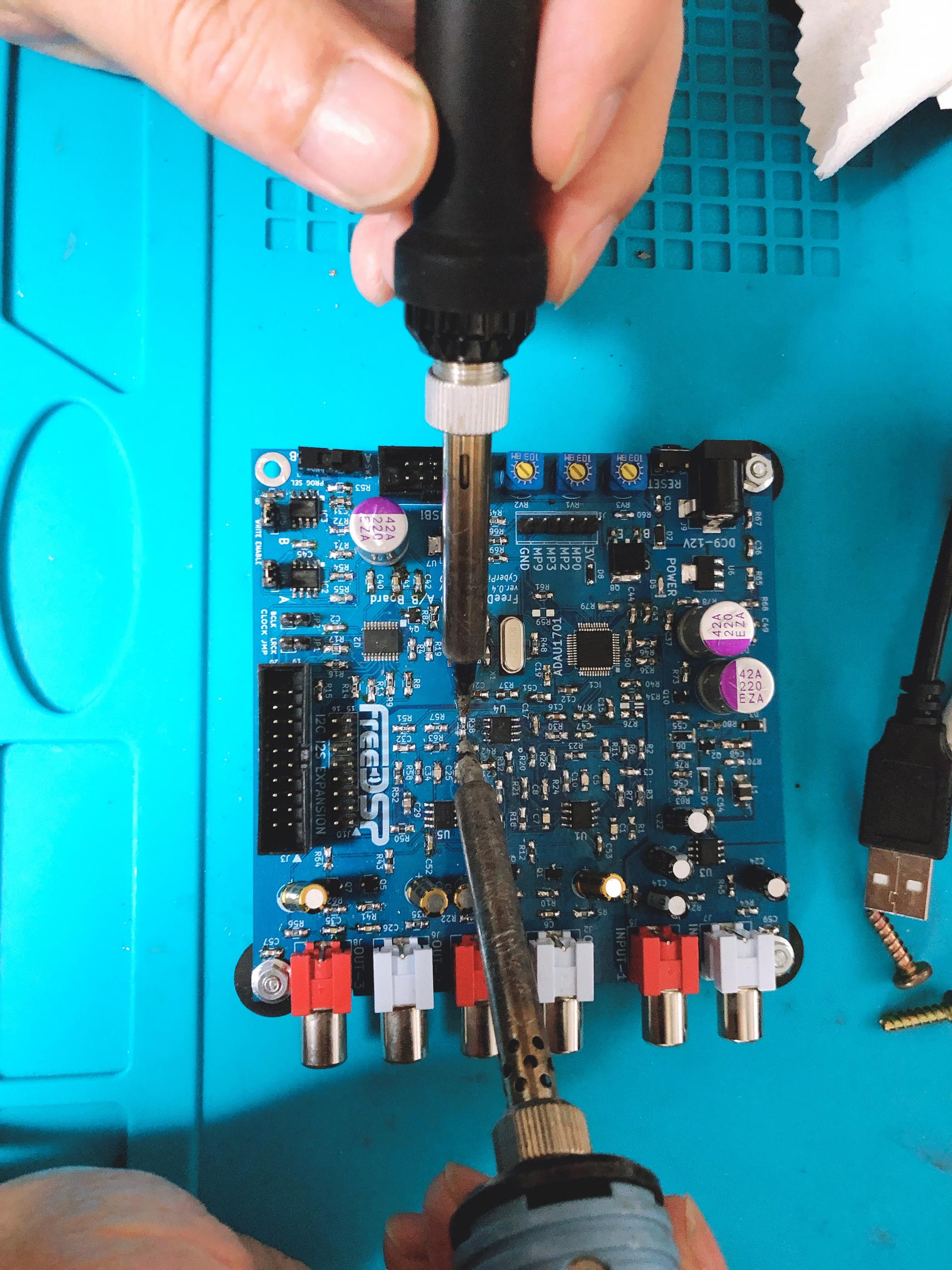

Hello DarkOne-San,
Well yes!
You can do as you like. Because it's a "DIY" 😉
One of technique to remove SMD resistor which using with two solder irons. (Photo attached)
BTW, I have ordered this hot air tool in last week.

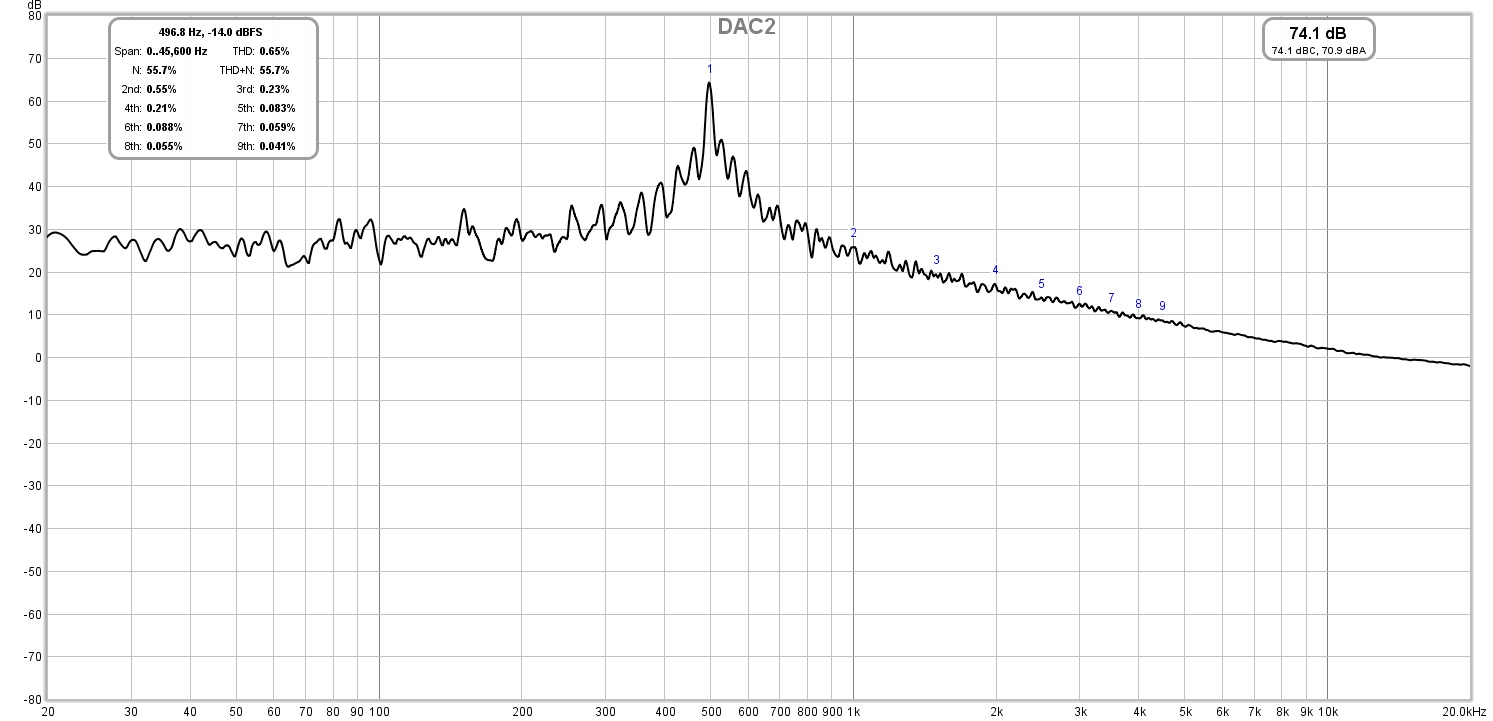

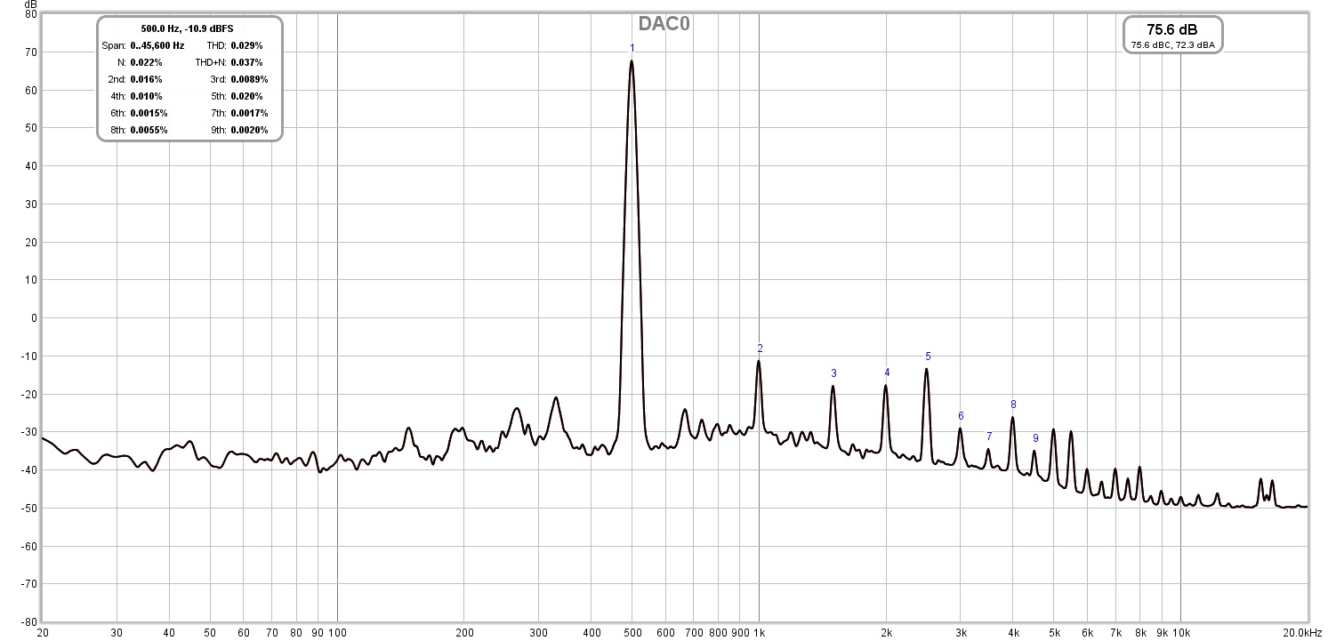

Hi Theol, unfortunately DAC2&3 are still noisy. Measurements are much better than what I posted earlier, it was probably some SW glitch in my measurement rig.
Anyway, DAC2&3 have 15-20dB more noise than the other channels, I posted. When I connect 93dB/2.83V tweeter to amplifier output I hear very low noise from DAC0&1 and loud noise from DAC2&3, so loud that I can hear it loudly 3 meters away.

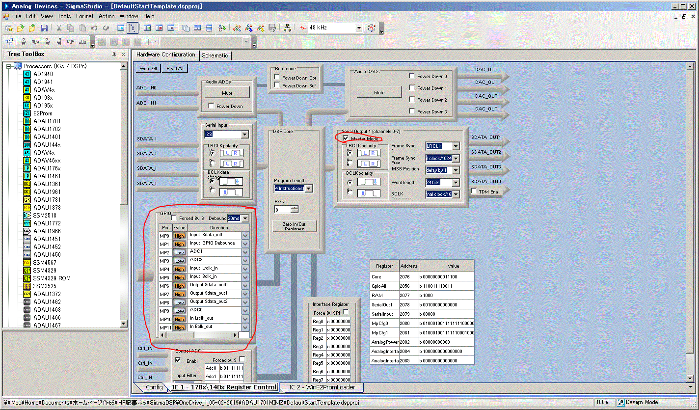

Set in Hardware Configuration(Top) Tab and...
Hi Guys,
You can configure MPx pins in Hardware Configuration(Topside tab)
then IC1 - 170x¥140x Register Control(Bottom-side Tab)
Simile as my board configuration
