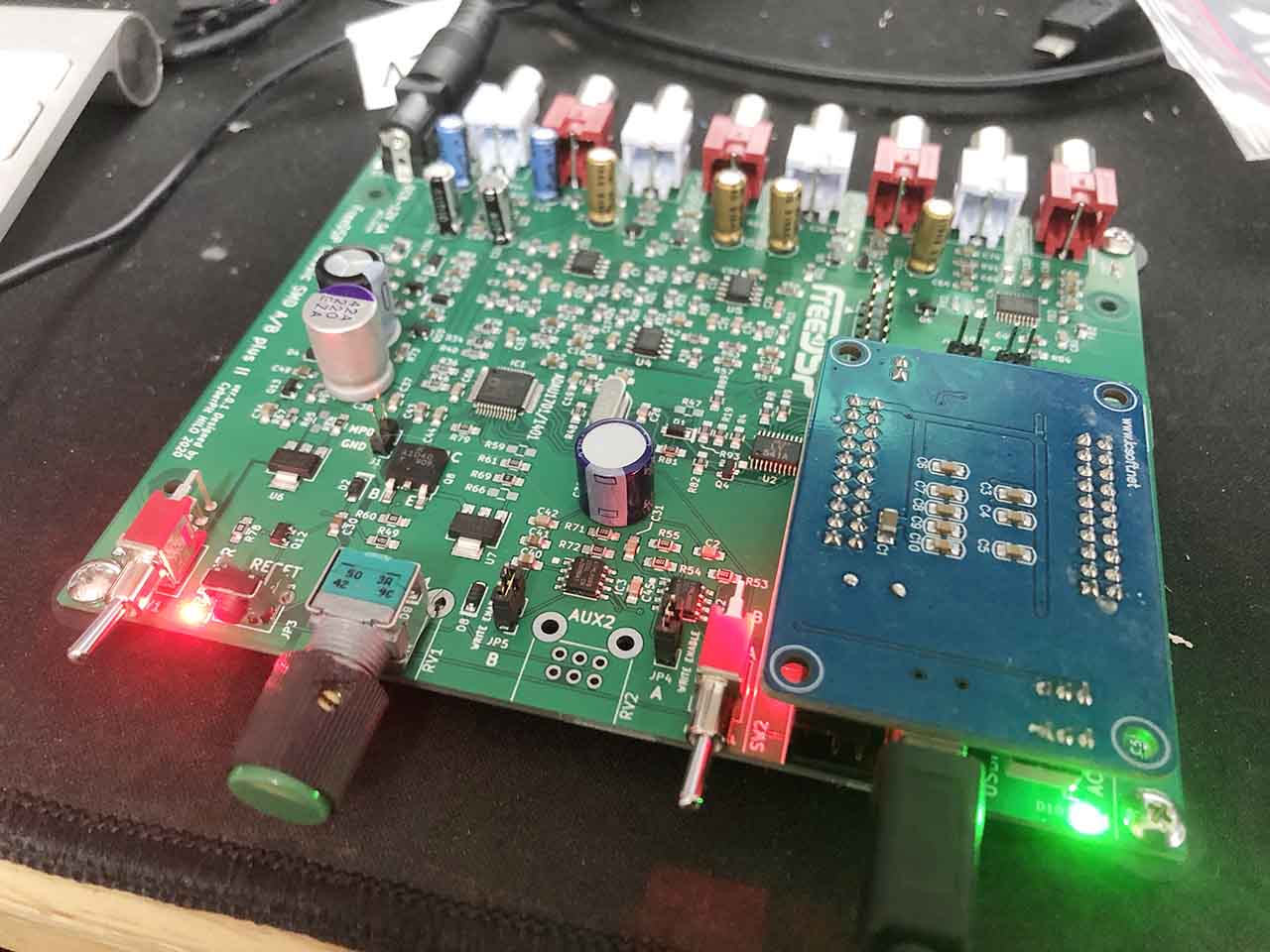

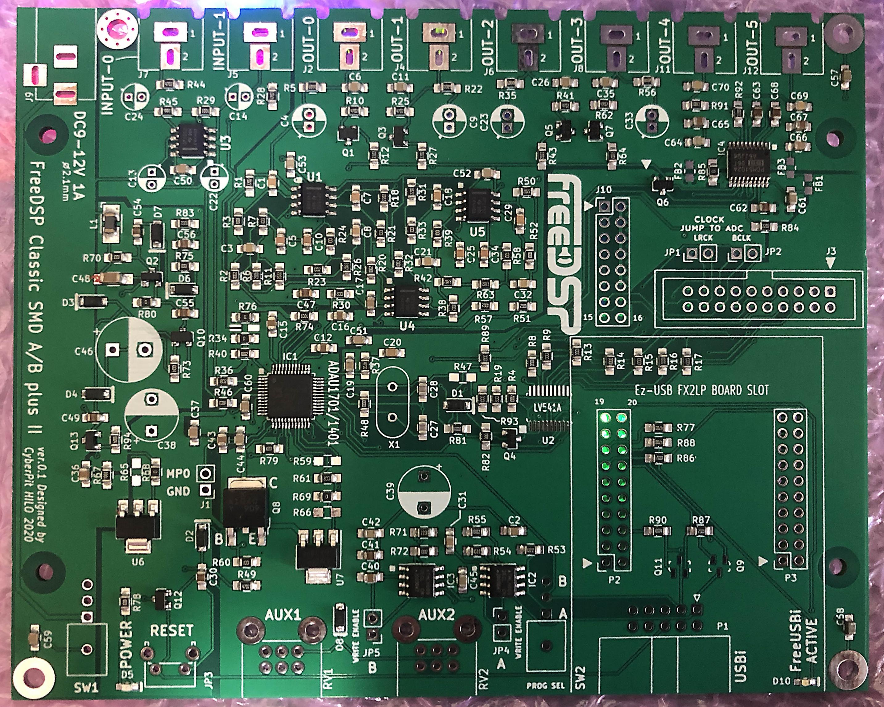

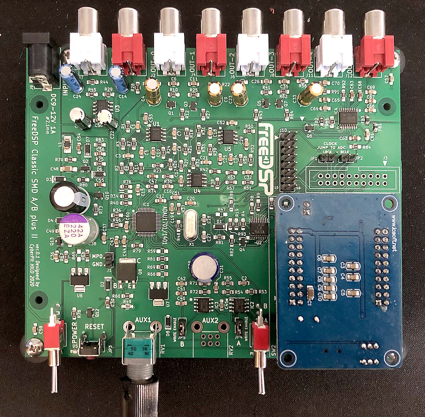

Now I'm developing a new version of "FreeDSP Classic SMD A/B" which is named "FreeDSP Classic SMD A/B plus II"
This board has two additional features. Embedded PCM5102 for DIG6/7 output plus Ez-USB Fx2LP board slot for embedded FreeUSBi .
The other features keep the concept as FreeDSP Classic SMD A/B.
  • Dual configuration EEPROMs for program A/B selection.
  • 2V r.m.s. Unity Gain I/O
  • Power ON/OFF and Reset muting.
  • I6S(3 times I2S) buffered digital output Header
  • I2S Digital Input
  • Single DC12V power supply.

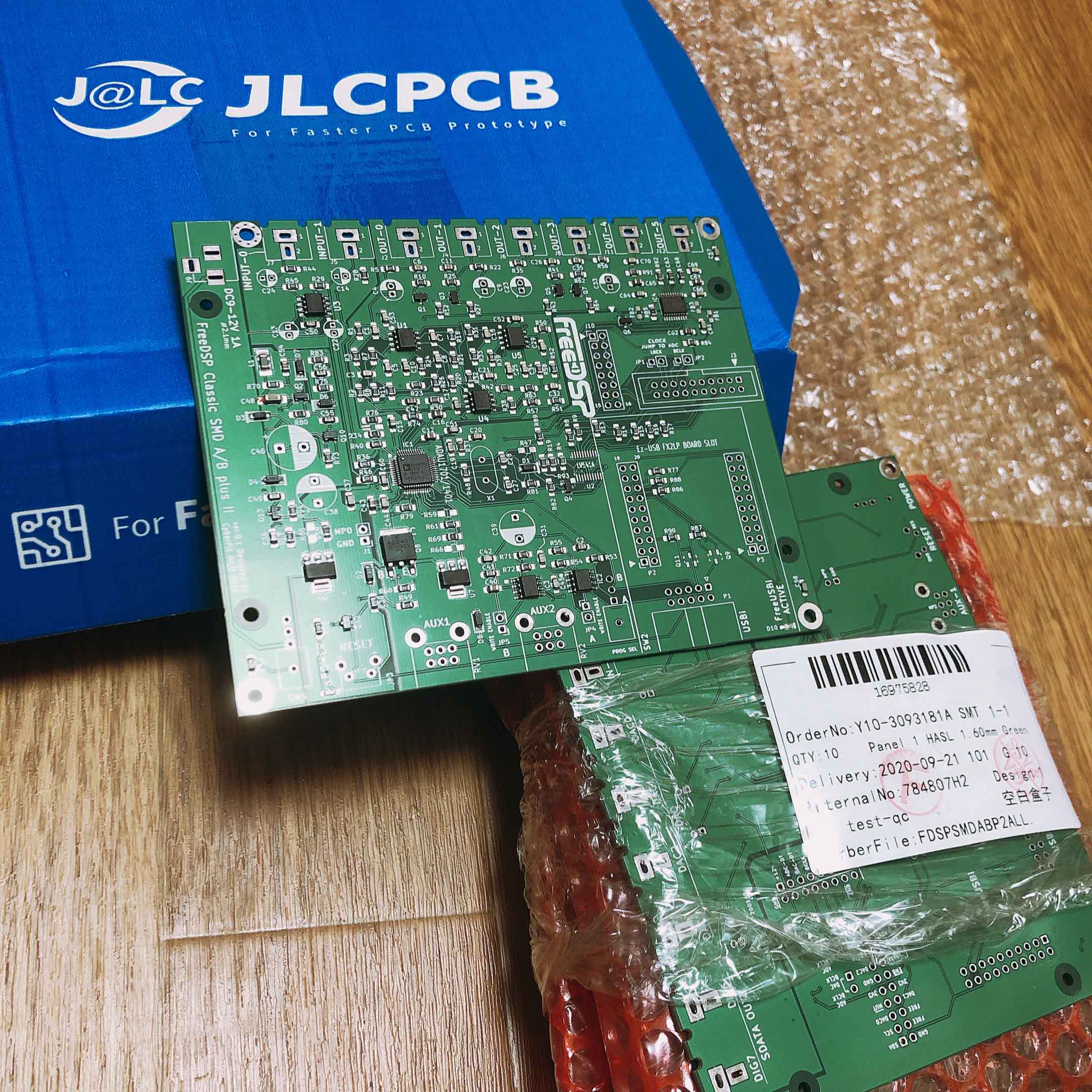

The current version board had PCBA done at JLPCB. Design information will be updated soon.

I would be interested in the other board you've showed in the other thread. From what I saw, it accomodates the ADAU1452/-66 chinese boards.
Any chance to get the gerber files?
'cause I think having the boards shipped from Japan to Austria would be verrrry expensive...
Thank you & Best regards!

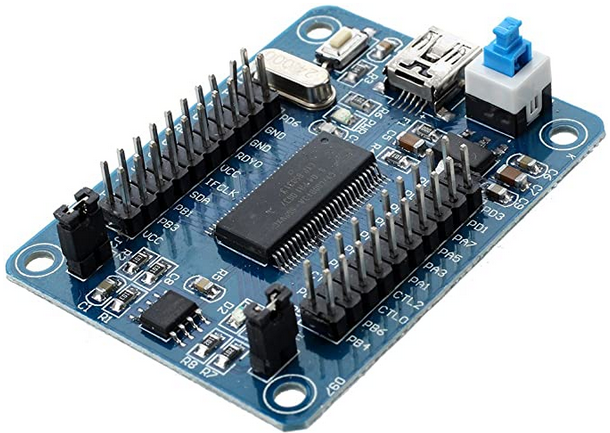

One query, the project files describe the USBi daughter board with an IDC connector whereas the photograph in this thread shows a USB micro connector, is a separate USBi programmer required or is all that is required a USB cable to the PC running SigmaStudio?
Design already evaluated and released
Hello mkec24-San,
Well, I'm asking to freedsp.cc to add on the list this design...
This version 0.2 design is my Design-Release. Previous version 0.1 board was evaluated by eight people. Fixing/changes between 0.1 and 0.2 are as follows...
(1)Change the Reset pull-up resistor R49 value from 47k to 4.7k
(2)Tie-down PCM5102A pin12 SCK to GND (Invoke PLL for 192kHz fs)
The rest of part is exactly the same as version 0.1, so I believe there's no changes ordered.

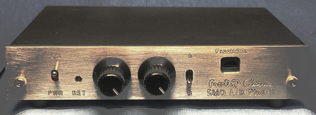

Embedded FreeUSBi Slot:
A daughter-board (Ez-USB FX2LP board) is completely the same as original FreeUSBi. One of compatible board image had attached below. You can use ADI's standard IDC-10P Cable from USBi or USB-mini cable even the cape-board installed. (Please use Only-One at a time)

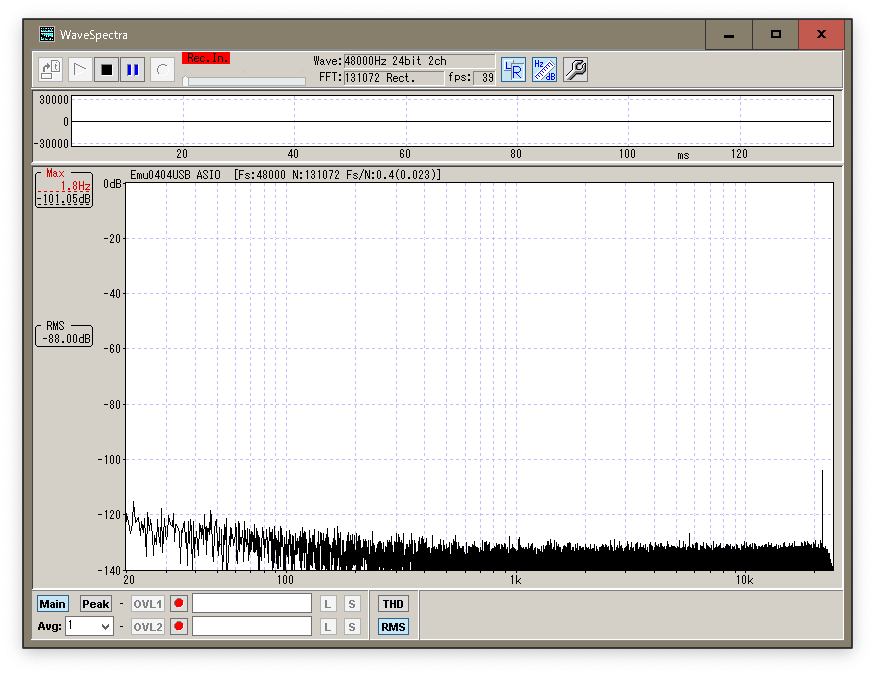

Looking at the data sheet for the ADAU1701, the ADC's & the DAC's have THD+N figures of 83&90db respectively so around <0.01%. Have you carried out any tests for your design?

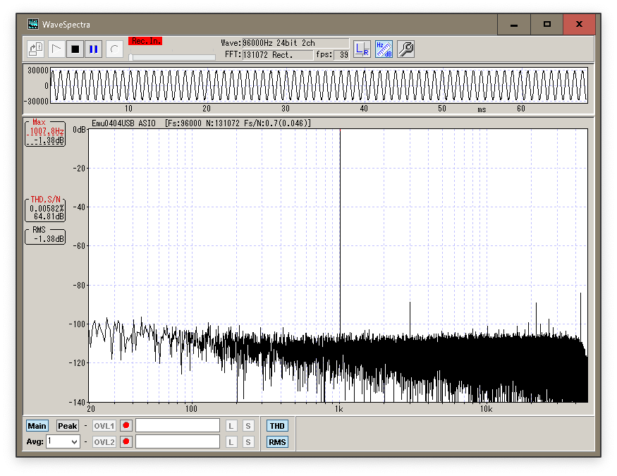

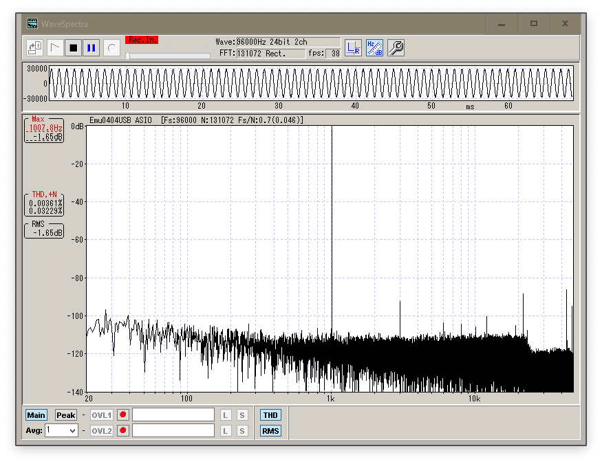

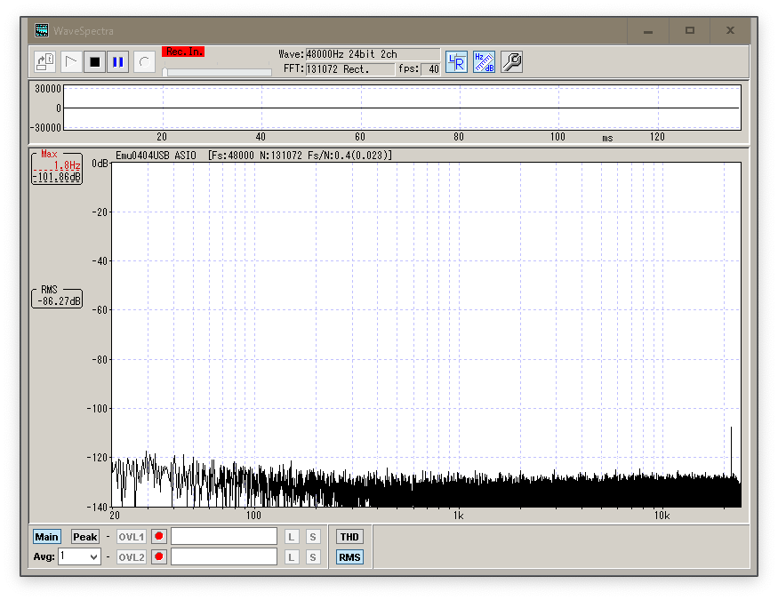

Hi mikec24-San,
Here's FreeDSP Classic SMD A/B plus2's actual measured overall ADAU1701 embedded ADC-->DAC through performance...
[Fs=48kHz]
Overall THD=0.0036%, THD+N=0.032%(48kBW)
Input Short relative to clipping level S/N=88.0dB(22kBW)
[Fs=96kHz]
Overall THD=0.0058%(22kBW)
Input Short relative to clipping level S/N=86.2B(22kBW)
