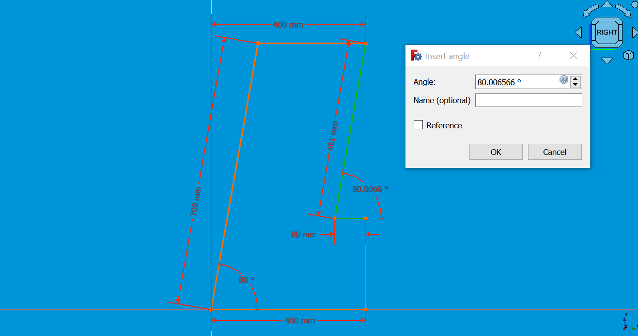

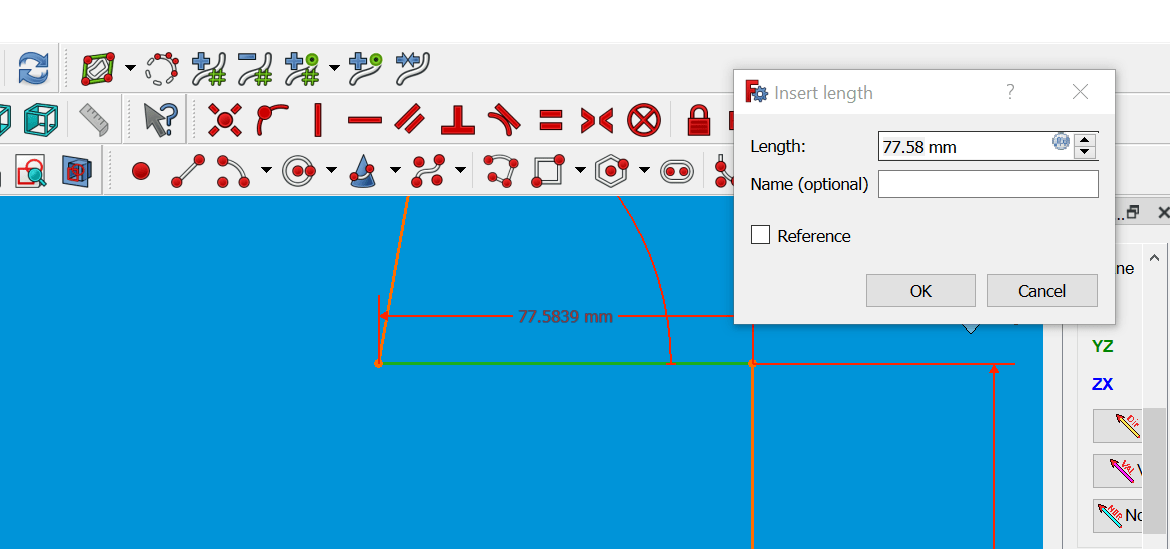

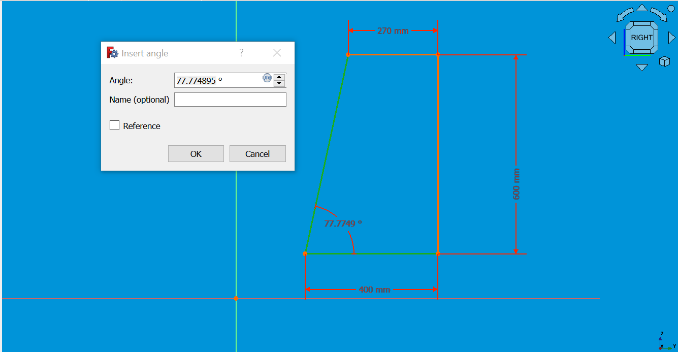

I see what you mean...I enter a dimension of 5.5555555555555555 mm, and it is saved as 5.5555559999999993 mm. I guess my parts will never be perfect. It seems to be an error in the sketcher constraint entry window. If you enter the value in the data tab, it is not rounded. Not ideal, but a workaround if you want to be that particular.And FreeCAD will still display a number after rounding it off.

But I have been trying to pass on my finding and my workaround by saying things like, "more exacting to carve out of a block by pushing and pulling of facets as well as terms like extrapolating a panel from the face to loft onto the board". And that If CAD displays rounded off numbers and this is used to locate the next part, it will never line up. How are you able to understand this when the experts can't? They make you feel stupid with their offhand brushoffs without ever actually not skipping over the presented info
A boat sim in FreeCAD will have negative buoyancy and if there was displacement output screen, the vessel would show as sunk unless FreeCAD could model a filler putty!!!! What I have come across would also explain a lot of print birdsnests. A true expert would respond to this by ignoring the print implications just raised and say something about just how accurately they can cut wood just like a padre in full form when asked about some weirdness in the book
It is very upsetting when the experts skip over the presented material, brush off the findings and their implications, and call user error. Or weasel out of recognising a system limitation by saying make a bug report. Well, this is not a bug. This is how the program works, and I maintain that the developers must be aware

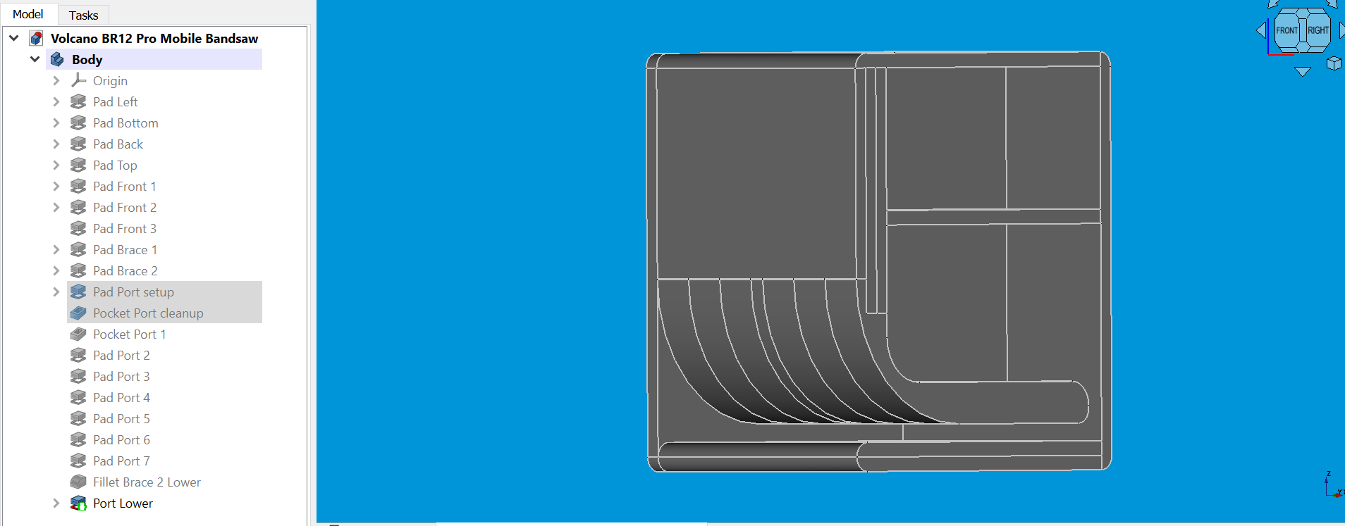

My recommendation to new users is to rely less on overlaying sketches on top of previous sketches and more on tugging on faces
