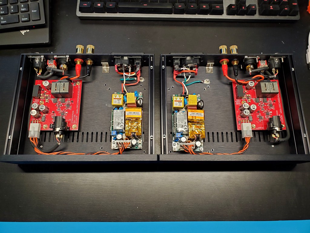

I populated my Starkrimson boards by hand. It was challenging, for sure. For me, the challenge is part of the fun and adds to my sense of fulfillment. I used a board heater and hot air station to install the GaN fets and flip chip parts. The other parts were installed with a hand soldering iron using normal solder wire and flux, and an HDMI microscope, A visual aid is 100% necessary in my opinion.
Here is my method:
First, I liberally applied flux to the area (Amtech 559 flux, strongly recommended!) I tinned 1 pad.
I added more flux. (Ensure flux is always present in the working area.) I heated the tinned pad and placed the part.
Then, I added more flux (if needed) and soldered the other pad.
Lastly, I heated the first pad again and applied slight pressure with my iron to verify the 2nd pad is strongly connected.
I used extreme care while populating the board, because it would be extremely difficult to troubleshoot a soldering or parts placement error.
Phillip,
Very nice advice and great build. The most challenging parts are the GaN fets and flip chip parts - where a stencil is very helpful as well as a board heater and hot air station as you say. Others can be hand soldered, since there are soldering trace leads on the board itself. Of course some parts are 0603 or smaller but that's part of the fun.
Patience and flux! For the advanced diy hobbyists 😉
