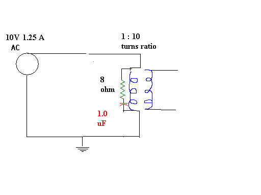

Okay, I'm getting a feel for this, but having just a bit of trouble with this inductor/transformer thing.
I tried drawing L1,then L2 according to the Kevin's formula, then putting in the K ratio, but it wouldn't fly.
So I got to the point where I was just ready to add the transformer, and hope I can be walked through on this. After this, I'll probably go to the support forum, but I want this one maiden voyage done here, if i can.
I figure 25H for the primary inductance, turns ratio 4:1, (if that means the secondary is higher).
I enclose a screenshot of where I am right now.
Just tell me what I do from here about the inductors and K coefficient, button by button if possible. Much thanks so far.

Well, I think I got it to work.
The circuit didn't work as I hoped, but at least I got a reading.
Turns out that it doesn't matter when you put in that directive for the SPICE directive to make the inductors into a transformer.
Circuit didn't work, but at least I can do a simple model now.
Much thanks to everyone for their patience.
