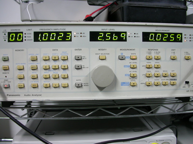

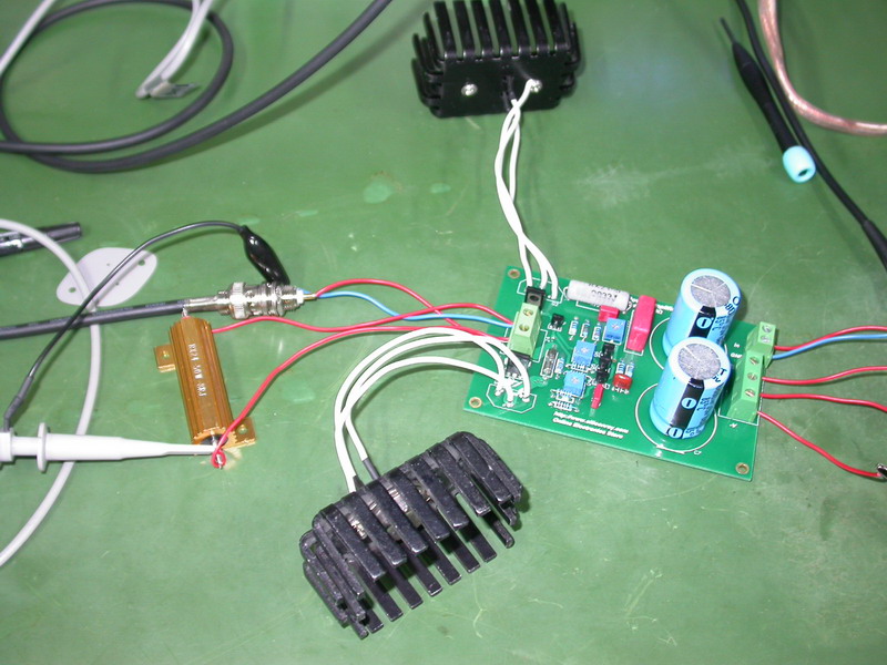

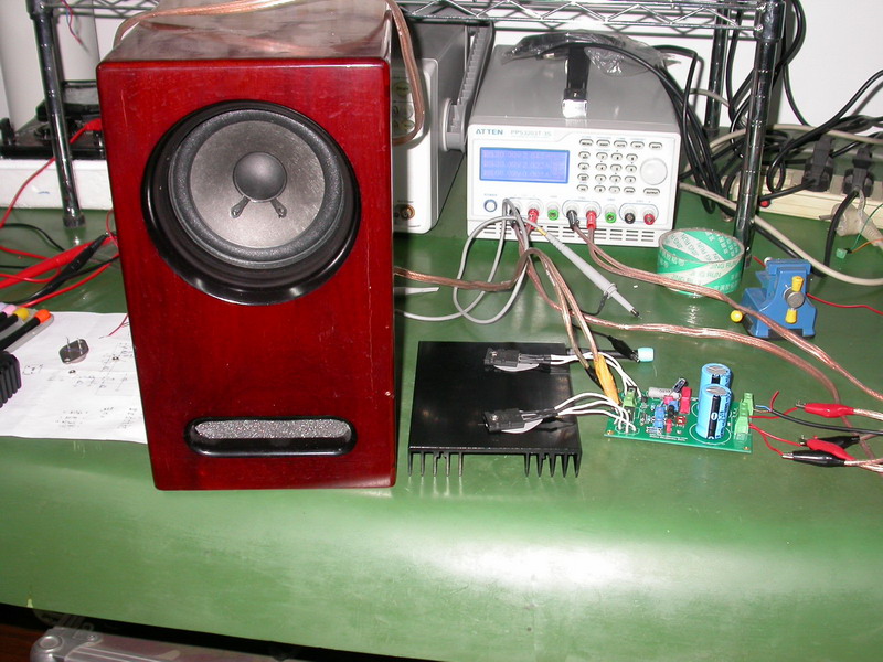

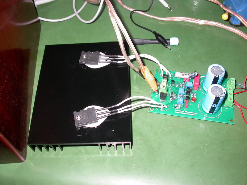

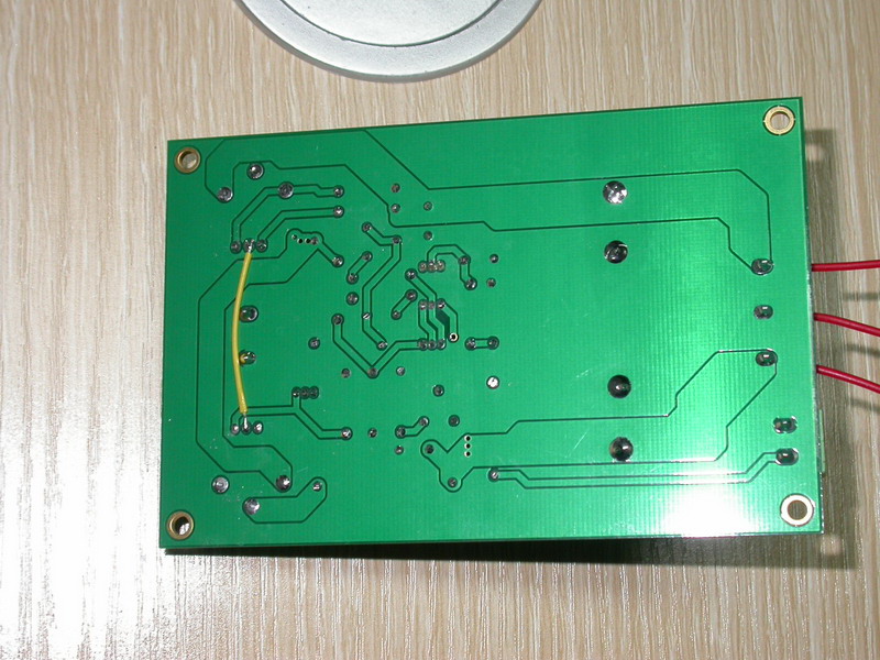

Today I'm sooooo happy with the testing result. After the following modifications of the original first design I posted:
1. VR1 changed to 100R
2. R13 changed to 10R
3. Q3 changed to BD139
The amplifier is working great! At the beginning the THD is 1% @1KHz/1W/8Ohm, pretty high for a class-A. I realize that Q1 and Q2 should be paired matched. Then I changed them with 2 pair matched transistors, the THD drops to 0.05%!
I also tried with some other transistors such as 2N3055, 2N3773 and finally 2SC5200. In my own opinion I like the sound of 2SC3280 most, high freq is very clear.
BD139 and BD140 works great in the testing. I think it's no need to worry about the high current. The don't have a heatsink and were slightly warm during working.
Hope your guys can also build a great amplifier when you receive my free PCBs.

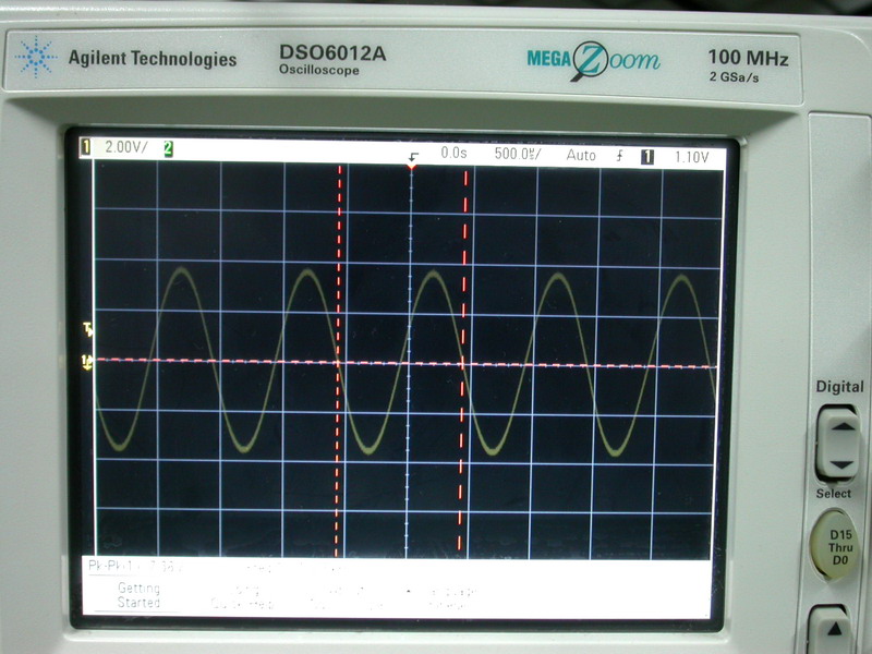

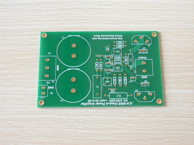

Bug and testing report
Sorry for forgetting to mention a bug on the board. A trace is missing on the fist version, the 2 collectors of Q3 and Q8 are not connected. A flying wire can solve this easily
Tested THD with different transistors, testing condition is 1KHz, 6Ohm speaker, 1W output power
2N3055: 0.06%
MJ15003: 0.03%
2SC3280: 0.03%
MJ15003 and 2SC3280 should be better options for Q1 and Q2
