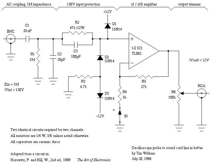

AND HERE IS A ADD ON FOR HIGH VOLTGE APPLICATIONS
as i am not very well versed with this type of software kindly tell me is it good enough ..
