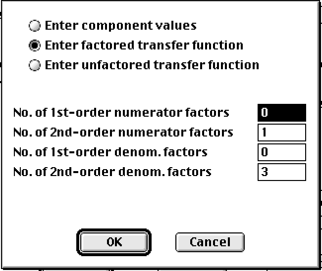

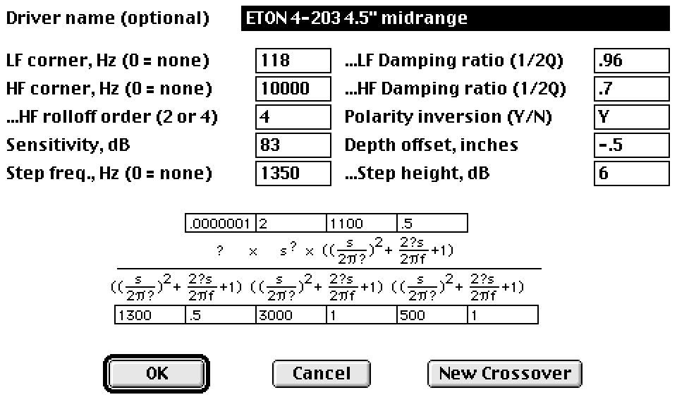

For technical types, LMP Pro lets you define the crossover in terms of the factored or unfactored transfer function, as well as via conventional component values. Here is an example for the midrange driver in a 3-way system.

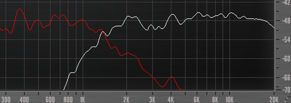

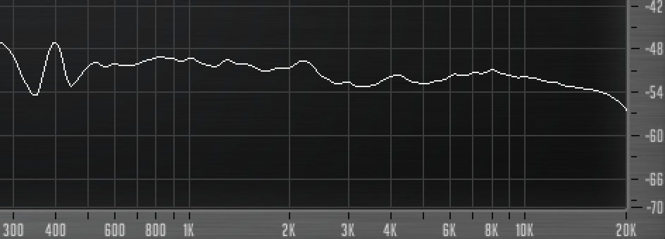

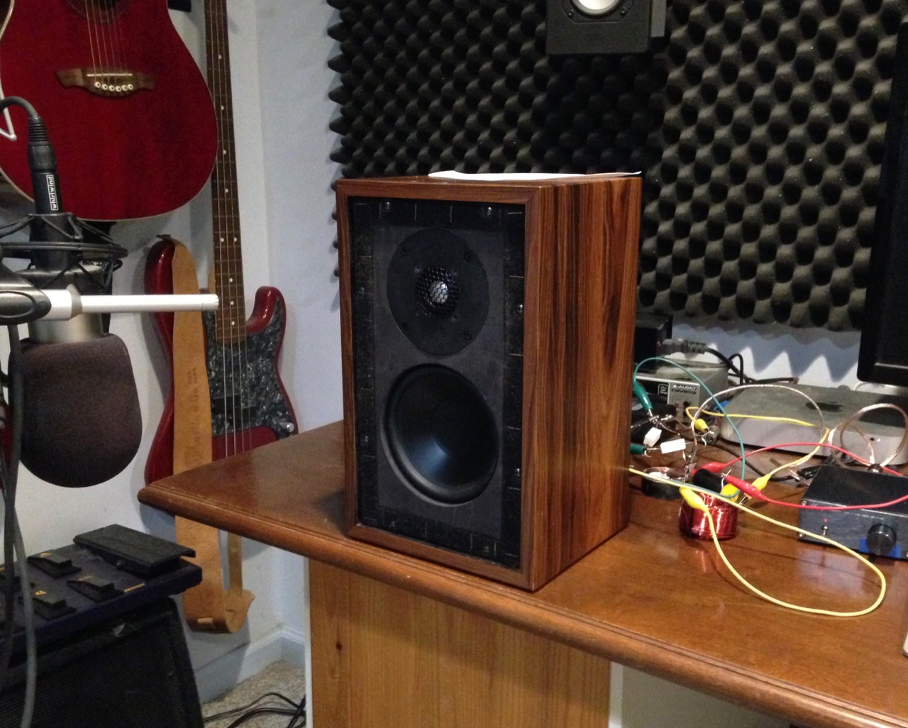

FWIW I recently fired up LMP Pro on my 2015 MacBook via the BasiliskII emulator, and used it to design the crossover for this LS3/5A homage.

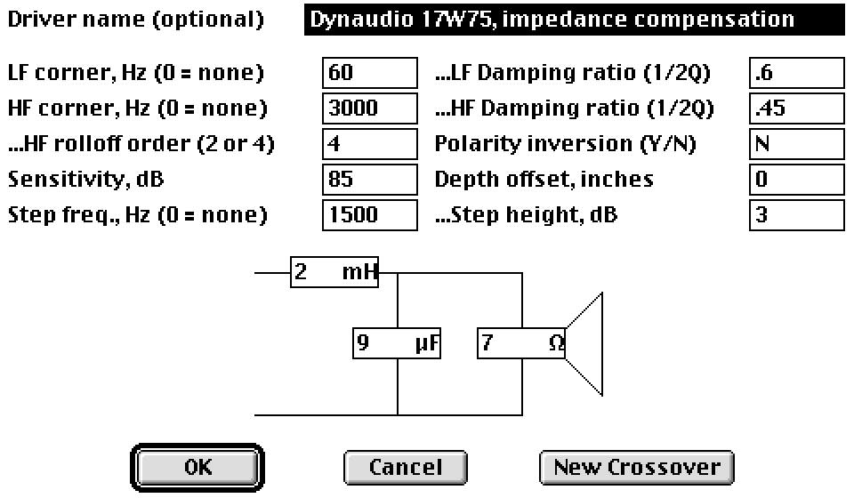

LMP Pro assumes a resistive load, so I used a zobel on the woofer. The tweeter did not need impedance compensation because I padded it down about 8 dB with series/parallel resistors which in this case reduce the effective impedance peak to only about 1 ohm.
I was gratified to see that LMP's summation frequency response for a 2nd order crossover agreed perfectly with measurements, including the effect of diffraction loss and the vertical lobing behavior (which you model in LMP by increasing/decreasing the "depth offset" of the drivers).

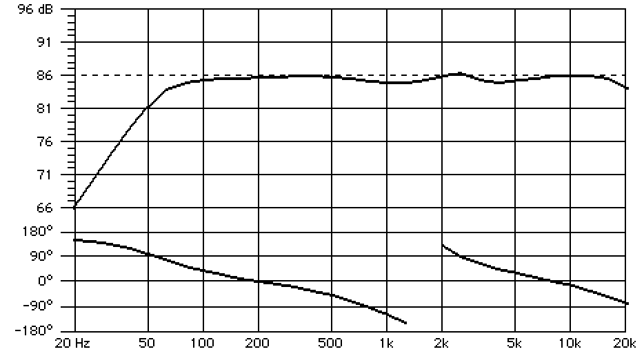

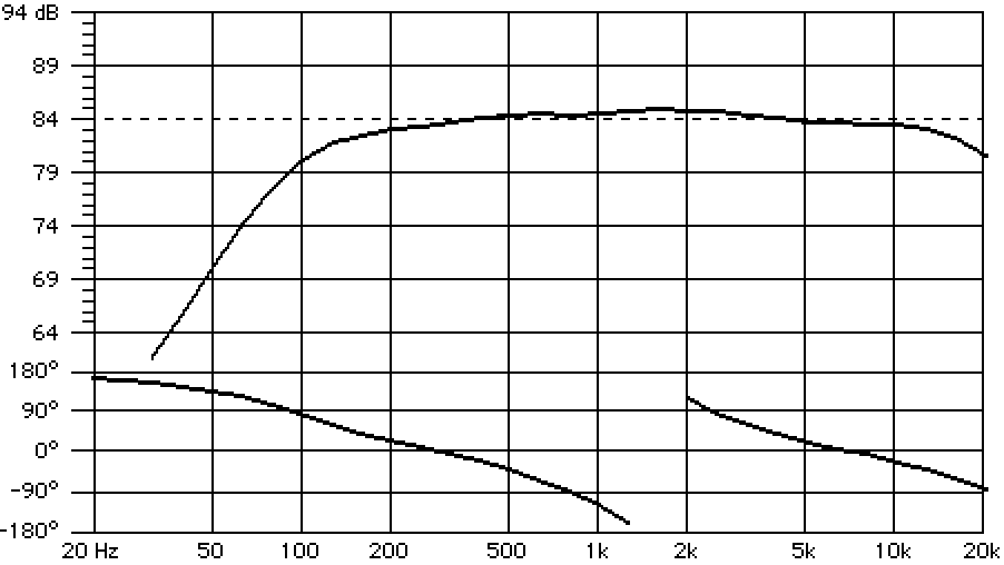

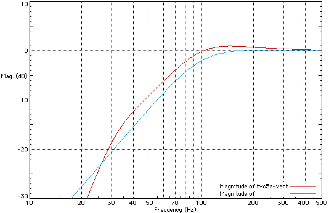

...and attached is the TopBox prediction for sealed and vented versions of this speaker, compared with measurements. Good agreement except for the bottom octave, which is likely an artifact of my close mic technique.
