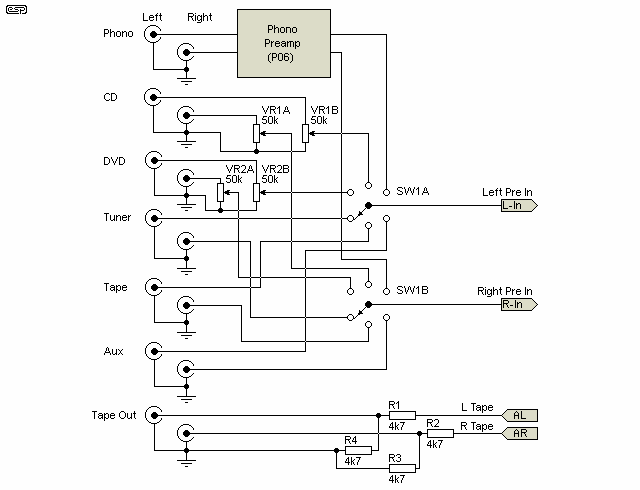

I'm looking for free software which will allow me to plan out builds like preamplifiers and amplifiers. Understand that I am not looking for circuit simulation software like SPICE. I only want to make professional looking diagrams like the ones I've included below. Notice how an entire PCB is drawn as just a rectangle. Does anyone know what software can make diagrams like these?

You can use LT Spice to draw schematics. Nobody will force you to run simulations, but later if you change your mind and decide you do want to simulate, well, there you go.
Other free programs can draw schematics also. A couple of popular ones are DipTrace (yay), Eagle (ugh) and KiCAD (yay).

That block is just another component that you can create and place in your library.
Most programs will allow you to do that.
The Schematic module packaged with Express PCB is free, nice looking, has lots of useful components and it's *easy* to learn.
Did I mention it's Free?
It's also very easy to self draw and add new components, and it has a "drawing with paper and pencil" feel.
Try it, you have nothing to lose:
ExpressSCH |
The drawing is meant to be sent to the PCB module or printed on paper but you can stop just there and "export" it to a standard Graphic format (.BMP or .GIF ,etc.) to be posted here, sent to friends attached to EMails, etc.
Best is that it has a short learning curve.
EDIT: here is a sample: the design of an attenuator/protector for PC Software Scopes (using the PC sound card as hardware) giving them a wide range and providing protection to the delicate inputs; drawn in minutes with Express Sch, exported to a graphic format and posted in a Forum:

Professional-grade schematic capture programs let you condense a circuit into a "hierarchical block" (or similar terminology). You then use the blocks in diagrams of higher-level systems. (If you take this concept far enough, you end up with a system schematic with only 3 elements:
