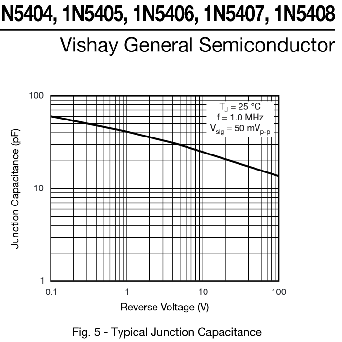

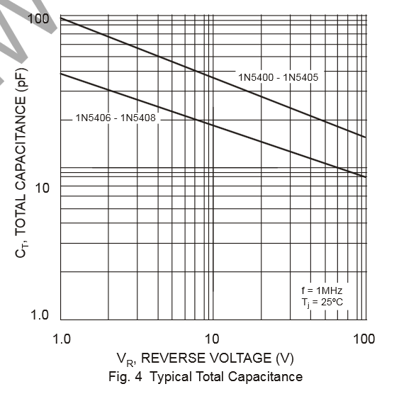

If that's really the problem then why not solve it with one of these 560pF, 3000v, $0.36 capacitors across each diode?
By the way I've copied the capacitance vs voltage plots for the 1N5408 from three different manufacturers. They all say the capacitance is below 100pF, and at 1000V reverse bias, WAY below 100pF.
