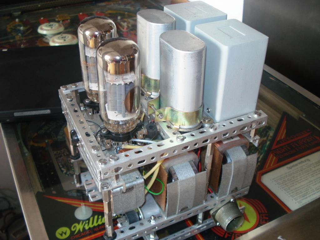

freaky new phonostage
like this😀

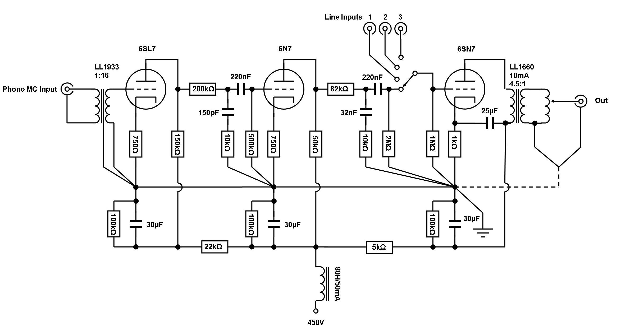

A while back I shared a design of a full function preamp with RC RIAA phonosection on AA. I call it the Octal preamp. It uses 6SL7/6N7/6SN7 tubes.
If there is interest, I'll open a thread about it and post the schematics

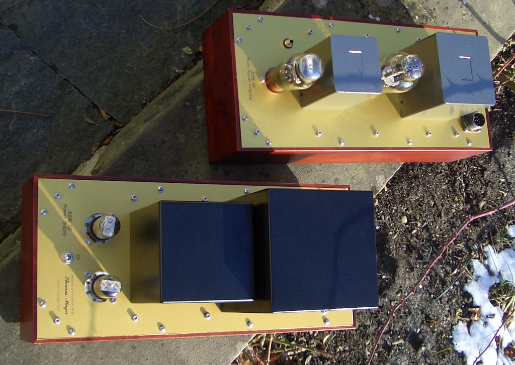

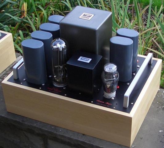

btw .... this one looks Fugly!
I got tired of that construction style myself and changed gears, especially since I went commercial some 2 years ago.
ImageShack® - Online Photo and Video Hosting
Do you like this one better ? 😉
That's my big phono and line stage combo, both with external PSUs, phono with EC8020 and linestage with 801A/10Y
Best regards
Thomas

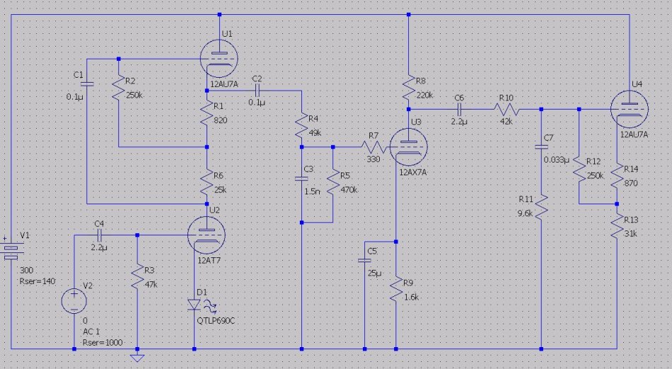

Thanks, I am always interested in seeing stuff like this. I had gotten it in my head that I wanted to try one using the 12A_7 series of tubes just for giggles. I can't find the latest version of the schematic right off hand but it is essentially like this with a 12AY7 instead of 12AT7 for the lower element of the mu-follower.

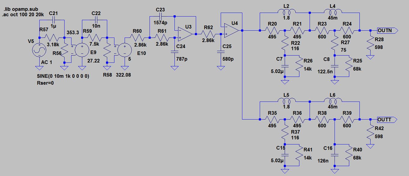

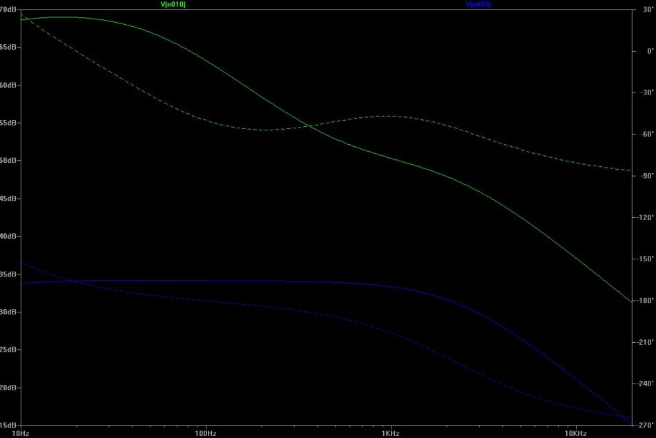

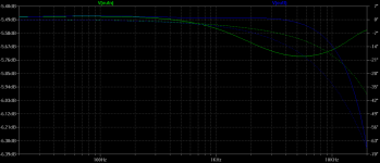

Hey guys,
This an example of compensation that I simmed. The filters are from a Neumann 1974 cutter. It will still be approximation as Neumanns is 2nd order. If you have Daves chokes, Lundahls or a EQ-2L you can adopt it. The blue is uncompensated.

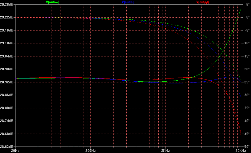

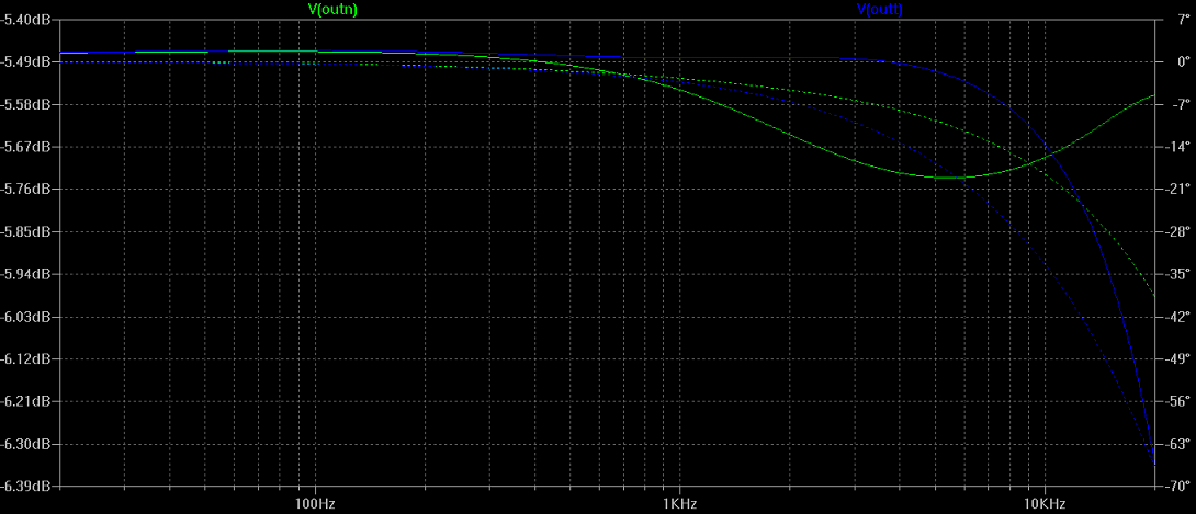

Hey Dave,
You can stay well below 0,1dB with 45mH, this has been showed at your place. What I now showed was an example of the difference between Neumann and std. Will surely be aproblem to do it IRL due to component-tolerances.
Below is another sim that shows the differences between std and Neumann. The *.asc is also in a thread at your place. Blue is Neumann-corrected. Now check tolerance 😉.
