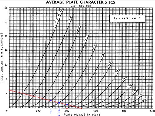

File this under Tube Learning I guess....
I am just starting to understand how to calculate the Plate and Cathode resistors for a given circuit as well and understanding load lines etc.
IF,
I Understand the math correctly...and that's a big if. Then, in the very first post of this article. the very first tube half of the circuit has 47K plate resistor and a 1.5K (1K5) Cathode resistor. this should equal 5ma of current through the tube. and should also equal about -8v of bias correct??
if that is correct. plotting out the loadline on a tube chart. this should then give a swing of +/- 27.5v with a +/-2v grid change.
The chart i used shows for a -8v bias, the plate voltage will be 172.5v and a +2v swing would drop to 145V and a -2V swing would rise to 200V = 27.5 volts either direction. correct??
this should = 55v P-P or a gain of 13.75 correct?? and 19.44vrms again correct???
Someone, please double check my math here.
I am only looking at the first stage and I am not, for the moment, considering the dynamic load line. I am just trying to make sure i understand the first step of the calculations.
IF,
