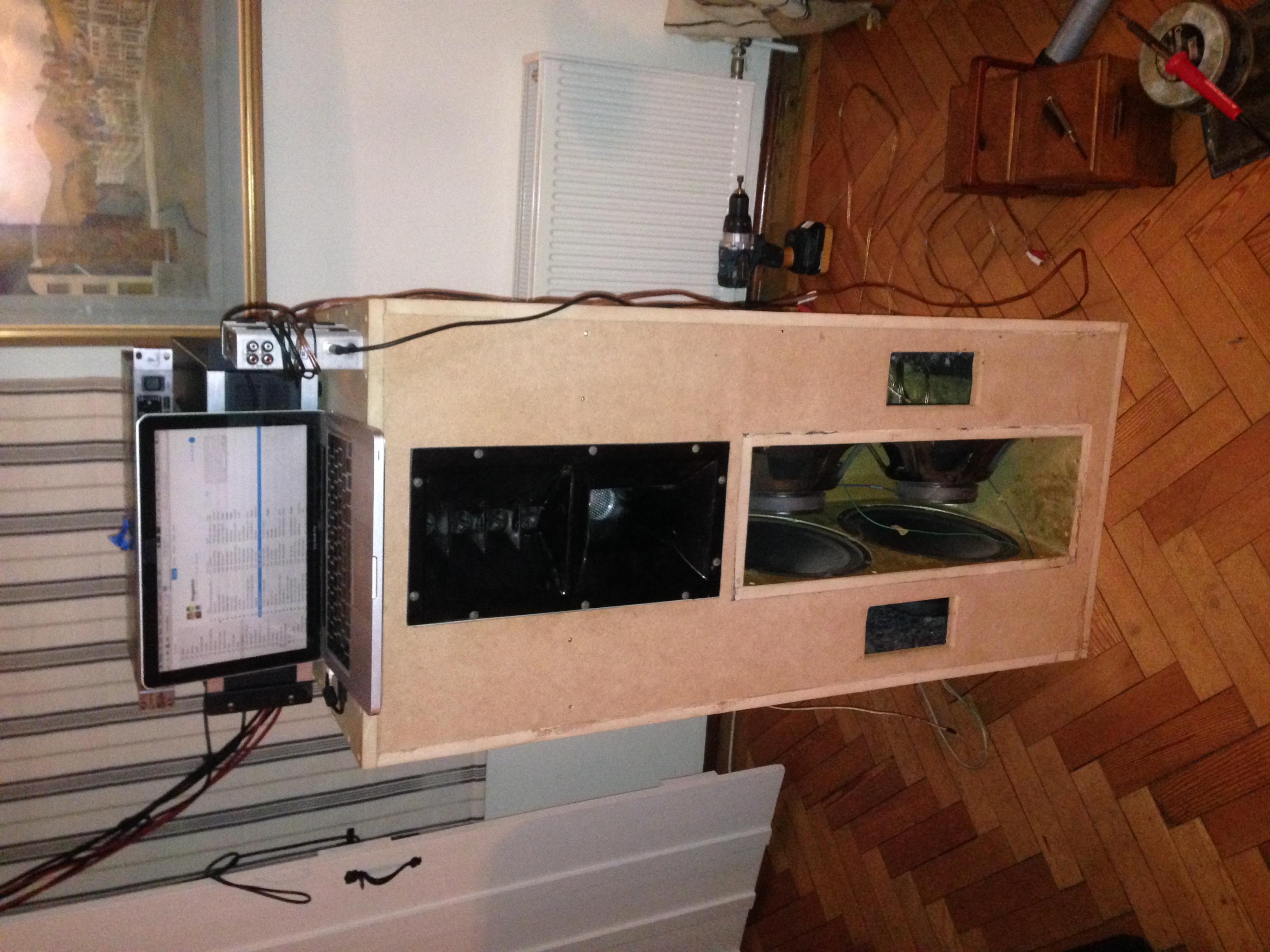

Well after a LOT of messing around with the amps i already had, and eventually just buying another one, a six channel power amp, to tri-amp with...
I have FINALLY fired up the speaker I have built...
And it sounds......
Great! full, tight bass, and definitely plenty loud!!
Or maybe I am just high from so much time and finally getting a reward. Makes you want to listen to everything!
By ear, been listening to some nicely produced music and so far i am happy (glenn adams - 'a beat for you' sounds amazing, the drum fill at the beginning really made me happy). Took me a while to figure out the DSP, I have just used the original Xover points, none of the more advanced functions yet. Also took a while to remember to mono my laptop, thought something was 'missing' for ages, only using one speaker... d'oh...
Will use the reference mic I bought to do some real tests for you over christmas, if I can figure that all out.
There is an issue with noise coming from somewhere, which starts sounding like a light storm and then would progress to a raging hurricane, loud with lots of interference-y fuzz, had to turn off a few times but now i've had music playing for a while it seems to have stabilised. When nothings playing/music is quiet you can definitely hear it though. Goes away when you turn off the DSP, does that mean its coming from DSP or before in signal? Grounding problem? I am going from laptop to audio interface to DSP to amp.

USB interface? And if so does it have balanced outputs?I am going from laptop to audio interface.
yep USB, and im even just using the headphone output because i haven't got my mixer at home... could be the culprit?
Headphone out of the laptop? If so yes those are often very noisy when on AC power, to test for this simply disconnect the AC and listen to see if the noise goes away when it switches to battery.
headphones out of the interface... tried disconnecting and connecting laptop from mains already. will try my bigger, better interface today which may help.

so i have been using my saffire pro 40 interface for about 10 minutes this morning, all was well until the snowstorm just came back. bad fuzz, some popping and squeaking, eventually dropping out, coming back. worrying!
turning off the interface doesnt do anything, but turning off the behringer does.
it seems to be something that gets worse after a bit of use, heat related? bad connections?

having done a bit of reading around seems this problem could go deeper than my powers to fix it...
edit, gave it a whack, noise went away. will open it up and check connections manually...
Did you buy the DCX new or used? Earlier models has a problem with the ribbon connectors but re-seating them usually fixes that, and in some of those same early boxes people sometimes found some leads not cut short enough on the main PCB and they were touching the chassis. Again it's an easy fix, clip the leads and/or add a piece of plastic or mylar between the PCB and case.
It was second hand. It seems the noise has settled down so my feeling is it is a mechanical issue, Ill have a go at what you recommend anyway, worth making sure it doesnt come back mid-event.

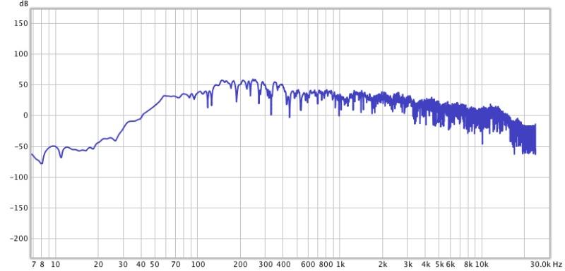

the scaling should be readjusted to -50 to 50 dB vertical, Horizontal boundaries 30 Hz to 20 kHz.
the cab seems to go down to 60 Hz flat.

That graph looks reasonably good. I'd suggest adding some light smoothing until the graph looks like a single continuous line, the super detailed response fluctuations are not something you want or need to correct. And I would also suggest setting the vertical scale to something like 0-120 or 130dB.
may I politely disagree, and suggest two versions:
1) one without smoothing, scaling as I proposed
(purpose of this graph is to examine the crossover points, how the slot loaded 12s and the midhigh horn interact)
2) one with smoothing as proposed by conanski
(to get the big picture)
while we're at it, some measurements of the other, original cab to see which one works better! 😀
