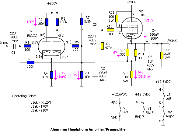

Diff.input stage.
Hi
About the 6AS7 OTL . Frank, you talked about putting the ECC83 in a differential input stage, using both triodes. Looking at headwize today I found a headphone amplifier with an ECC83 in differential input stage. I attached the schematic.
Is this what you meant for the diff. input stage If yes...where should I connect the feedback?

Actually, I think it was you who wanted it that way...Not me...
Look at the circuit of the ECC83 carefully and now look at the first stage of the Rozenblit amp using a 6SN7.
Hmmm, that's going to demand some polarity analysis...otherwise you may end up with positive feedback.
Any particular reason why you'd want it with a differential stage on the input?
Sure enough it's not going to give you a balanced input this way so I see little point in it.
Maybe someone else has a clearer view at 3.40 AM, I don't.
So, why not build it as is?
It's great sounding the way I suggested and gives you extra power to kick the woofers around.
Cheers,😉

Just use the same specs for the xformer as per BR on a per channel basis, use the 12AX7A as a diff amp and put the 6SN7 in // to drive 8 tubes iso 4.

The feedback, in the circuit you provide in post #26, must be connected to the point of interconnection of R5, R7 and R8.But it must be connected with a capacitor in series because there are DC voltage at this conecting point!
This circuit have not be designed with the aplication of global feedback in mind...but it can be done...😉

The diff amp is used as a phase flipper with gain because you can't flip the phase at the headphone jack with a common ground. There is no feedback in this circuit, just gain and a ballsy cathode follower. I'll bet it sounds good.
MODS: Build a regulated (-) supply out of the filament supply, put a ccs diode in the diff amp tail to the (-) supply and GET RID of all the coupling caps except at the output. Let the CF float at the diff amp plate voltage, it's 30 volts away and regulate the b+ to the output tube.
Add NF at the r.h. triode grid will improve the bass, I'm sure. 10 db ought to do it (at the expense of gain).
