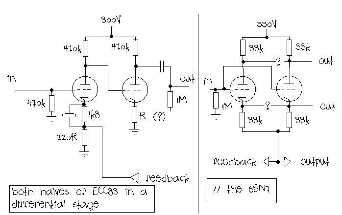

Questions about DS and paralleling
After some search on the net I have found three links related to a differential stage. I drew what I think must be the ECC83 in a differential stage. I don´t think it is right (it seems to simple to be right). If it is right, I don´t know the value of R in the schematic. I believe R determines the gain of the stage, and I´m looking for a gain of 1.
I also drew the // 6SN7. I´m not sure about the lines connecting both pins # 2 and # 5 to the output; # 3 and # 6 to the inverted output.
I am curious why they use a 2,2muF/630V coupling cap. This is a rather great and hard to find value. In most schematics I see 0,1 or something close being used. I used the crossover formula and got 0,07Hz crossover frequency (for 2,2muF and 1M resistor). What happens if I use a smaller cap there?

Hi Erik,
If it were me I'd drop the idea of the differential input stage.
That drawing is correct.
That formula doesn't apply here as the 1M resistor isn't referenced to ground.
Olá Erik!
Yes...your suspicion are right...the schematic that you post of a differential stage is not correct...in fact it's a two gain stages DC connected...
For a exemple of a diferential configuration see:

Frank and Tube_Dude, obrigado pela informação
The schematic from tubecad seems a lot like a schematic from a differential stage I´ve seen in a pre-amplifier.
In the schematic from tubecad the phase splitting is done through the differential stage, the outputs from the phase splitting feed to the EL86 tubes. In Bruce´s OTL the output of the ECC is connected to the first 6SN7. I would say in a "single ended" mode, because the phase splitting is done through the second 6SN7. This fact must imply putting in a differential stage won´t be limited to just the first stage.
Well, because the whole thing seems a "bit" complicated I will print and study the TubeCad document before doing any further comment.
