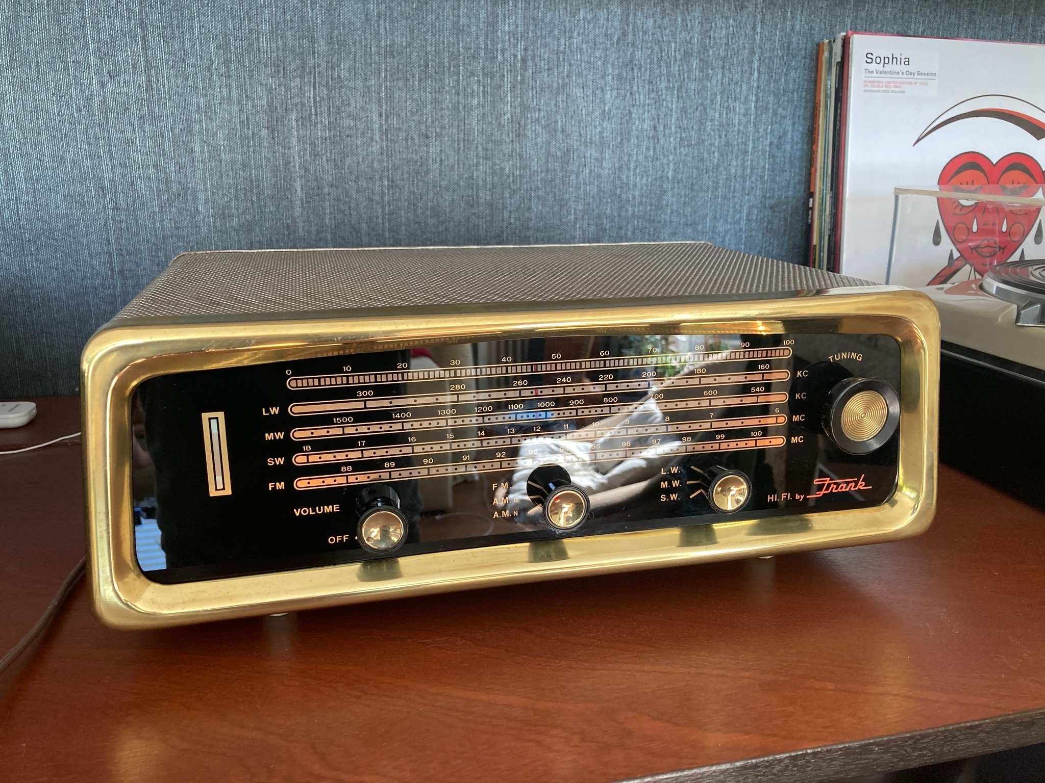

I noticed a couple of scratches in the paint on the front panel bezel. It looked like brass underneath, so I went for it 😀
Why would anyone paint a beautiful piece of brass, when all it needed was a polish and lacquer?
Well, properly chuffed now. A friend Russ of Russ Audio found the matching tuner from an associate of his in Belgium. It's all packed up and on its way here. I'll post more images when it arrives and I open it up.
