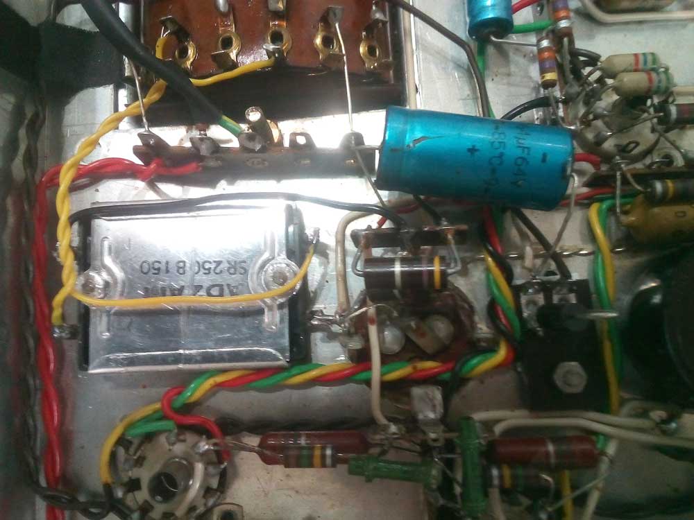

I have a FRANK pram 30 watts Ultra-linear Stereo tube amplifier, in which I am replacing the selenium full wave rectifier with a diode full wave rectifier, I am also replacing the selenium bias rectifier with a diode, as well as replacing the electrolytics.
The details of the amp are below.
I have a schematic, but it is missing some vital info. The selenium rectifier had a forward DC resistance of 295K and was pushing out 345V. As selenium rectifiers don't age well, I don't know if the 345V being output is too high or too low. As the forward resistance of the diode rectifier is much lower, the output is going to be much higher. What I am trying to find out is what the original design voltage should be. I'm not worried about the bias voltage as it's for the 4 x EL84 so should be about 11.5V I'm guessing.

If you can figure out how many "cells" were in the selenium rectifier, then you can figure out what the voltage drop should have been. Roughly 0.9 - 1v per "cell". If you want similar characteristics, you can add a 5W or 10W resistor in series with the diode to affect the same voltage drop and some amount of current limiting.
Better, if you can find out what the B+ "should" be, work to that. Since it's also likely that mains voltages have increased, you can factor that in at the same time.
All that said - if it's high by 5-10% - it is probably not going to cause a huge problem, provided you can set bias correctly.

I should add. 1v/cell is at low current. If the amp loads it quite a bit, you'll want to factor in the series resistance too, somewhere 100-200 ohms and as you surmise likely increases as the device ages. Should get you close to the mark if you can't find service data.
Did you use UF5408 for the replacement diodes? and what are the part numbers of the selenium stacks?
The diodes used are 1N5408.
I tried looking the numbers up, but didn't get very far.

Strangely although the given voltages are 110/240 the voltage selector is marked at 110/130/145/220/245
Seems like the first number on the rectifier is the voltage rating and the second is the current in mA. But just writing that made me think of 'granny sucking eggs'.
Thats correct, but these things are all built the same so if you have a datasheet for a part with similar characteristics you can use that datasheet.

Does anyone think that using Vishay UF5408 ultra fast soft recovery diodes instead of standard 1N5408 for the new power supply and bias rectifier will have any significant effect on lowering the power supply noise produced?
390V B+ - about 13% over the original.
Bias on the valves is 13.5V. So if I use a resistor to get me back to 345V the bias should go back to about 11.75V.
I have also changed the bias diode for the same type used in the rectifier.
That's a lot, didn't know selenium rectifiers were that inefficient. Did you also experiment with adding a series resistor for each diode? May be that will be more effective in smoothen the PS noise than a (larger) single resistor after the rectifier. Won't look original then 😉
What voltage do you measure at the EL84 anodes? They will have a short life at anything over 340 volts in fixed bias...
You could measure the total current draw if you measure the voltage drop across the 50Ω
resistor from the rectifier (eg by Ohms law, 8 volts would equate to 160mA and so on.)
From that you can guestimate the dissipation of each EL84 and try and keep it below 14 Watts each... some EL84s are not as good as others.
