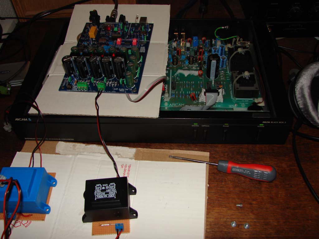

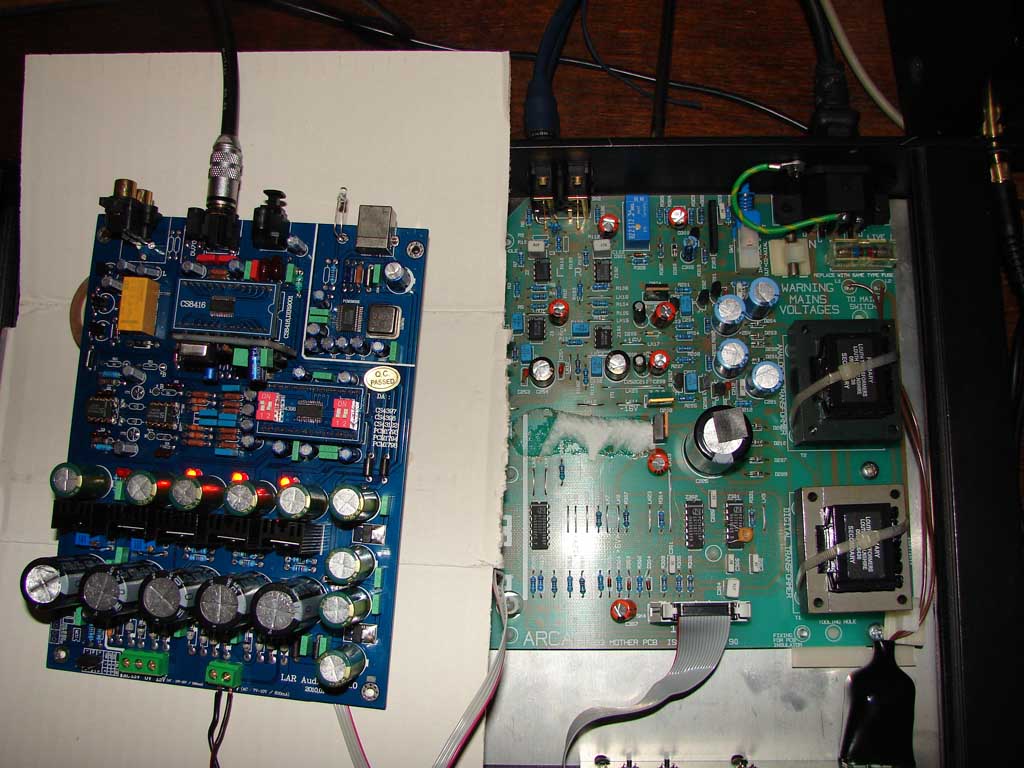

I simply used the signal from L- and R- and connected it to the Black Box using some USB-motherboard-headerthingy I had laying around. It ain't pretty but it lives.
I guess a "how to mod your BB3" is not very usefull, but to anyone owning this DAC I can recommend this mod. (not to be used on Black Box 1 and 2 for obvious reasons)
