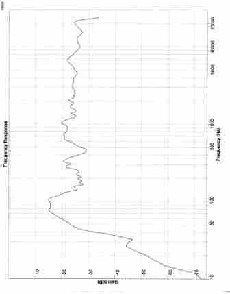

Performance of FR125S/WR125S ML-TL (Part 1)
Earlier in this thread Dave (and perhaps others) reported issues with ML-TL designs that use the FR125S. I have taken a series of measurements on my version of GM's bipole ML-TL design. A complete disclosure of this design is located at:
http://homepage.mac.com/tlinespeakers/FAL/downloads/BipolarMLTLDesignPak.pdf
I have listened to my speakers for a few weeks now and I've tried material with fairly heavy bass (for example, Keb Mo's recording and others) at levels in the 90-100 dB SPL range. I have not heard the speaker bottom out nor a discernable port noise. I decided to take some data to report on the performance of my speakers.
The attached plot is a measurements of the performance of my speaker taken in room (my garage) at a 1 meter distance. This plot shows room effects and likely a bipole dip in the below 600 Hz area. Hence, I would say that you shouldn't assume that this plot represents the true performance of the speaker below 600 Hz. I'll post a near field measurement in the next posting (Part 2) on this site.
This plot does show that the speaker has a flat frequency response (within +/- 3 dB from 600 Hz to 20,000 Hz).
I'll continue in Part 2.
Jim

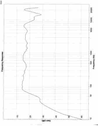

Performance of FR125S/WR125S ML-TL (Part 2)
I next measured the frequency response at a distance of 3 inches. At this distance what is plotted is the bipole performance of the speaker but without the any room effects/reflections. This plot has a practical upper limit for accuracy of about 900 Hz so you can ignore data beyond that point. But within the window below 900 Hz, observe that the performance is outstanding--very flat.
In both plots in Parts 1 and 2 the low end of the band does not include output from the port. You can observed in the near field plot that a small dip (the port and driver outputs are 180 out of phase at this dip) occurs in the lower end rolloff skirt near 40 Hz. The dip in the far field plot occurs just above 30 Hz. The acoustical addition of the port measurement to the near and far field plots would fill this dip and extend the low end 3 dB rolloff lower in frequency than observed in these plots. Note that the phase between the port and driver output varies so they don't necessary add dB wise at all frequencies. For instance, the near field plot rolls off 3 dB or so at 65 Hz but in reality the low end would extend below that point if output from the port was included in the plot. My listening would indicate that these speakers approach GM's calculated 3 dB at 45 Hz.
Once you integrate the data between the far and near field plots as I suggested, the performance of my speakers shows to be very flat over the entire frequency band. I don't see issues in their bass response response with their current length of 40 inches. While others have suggested that the ML-TL line length should be shortened or the port stuffed, I'm not in that camp. I think that this design is near optimum with the current parameters. While room effects and stuffing can be changed and these changes would influence their in-room performance.
Jim
