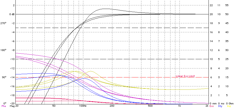

Sims show that the FR125 will pop into a sealed box between about 3 & 10 litres, depending on how low a Q works for you (or what size containment is handy)
dave
Here is the sim... Q = 1, net volume 2.5 litres
Q= 0.7, net volume 9.5 litres.
Q = 0.64 , net volume = 18 litres
dave
