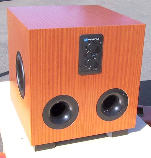

It's still in the rough stage but I have a pair of boxes with two of the WR125's and a tweeter and two Extremis' in their own box with a plate amp. Sounds OK. Gives the bottom end lift that the FR's miss.

Apex jr subs
Dave D has a push/push bipole using a pair of these "value-mart" priced drivers which certainly works quite well indeed.
Steve at Apex Jr also has some excellent plate amps for cheap - I particularly like the Audiophile with remote volume & crossover control.

As you know i am pursuing this idea. We have a couple plate amps arriving tomorrow (it was a bit of a struggle to find ones physically small enuff to fit on the back of the box) and the Extremis are sitting waiting. This may have to get swapped a bit as we have 2 sorta similar extremis projects on the go (+ the push-push extremis sub), the FonkenWoof (which also goes under the miniOnken) and the StealthWoofer (no i'm not saying anything about that one).
With active amplification i'm aiming for a 80-100 Hz XO so that the aperiodic roll-off can be aufmented with a single cap on the amp to get 3rd-4th order roll-off. We will also try passive. Because of the size of the components involved this would need to be in the 250-350 Hz range. I'm going to try series 1st order, and choosing a point closest to the bottom of the saddle in the impedance curves makes sense to me.
In the HTFR, Al ended up closer to 400 Hz i believe.
