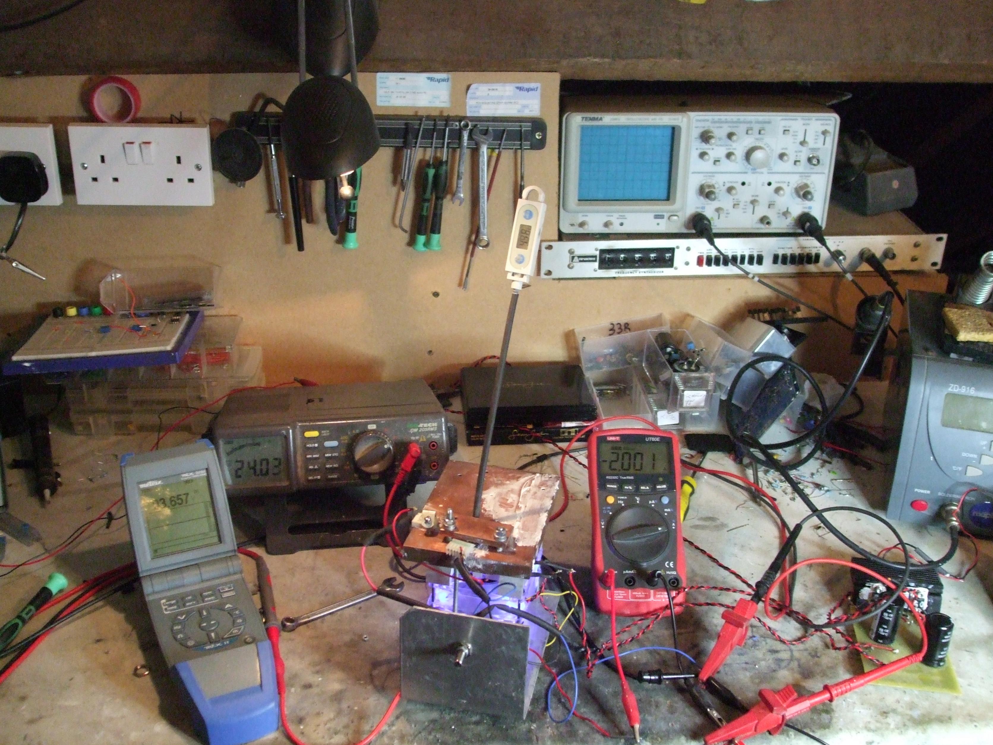

Funny how 24 V 2 A I am doing the same but got no problem with mosfet getting hot as I am using a constant temperature rig and take VGS at 50C
no mather which day / time it is and how many time I mesure them I always get same results

I'm using a heatsink with temperature controlled forced cooling 😉 Hannes

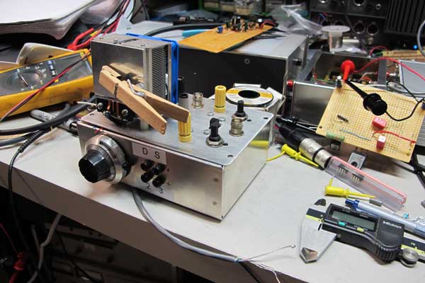

My wife was talking about "micro-pipetting" this morning and how it is important to establish a rhythm as you fill up the cell lines and make your standardized runs. It's the same with matching MOSFETs -- you put them in the test jig for only a certain period of time and move onto the next. I would sometimes take out a batch I had matched weeks earlier and using the same technique get Vgs and gm to line up perfectly. I would say that one thing to try and keep constant is the ambient temperature when you start out matching. My lab runs around 21 degrees most of the year.
I made this other jig, but found that the results weren't any better than the original method.
It does help if you current limit the test jig, fwiw.

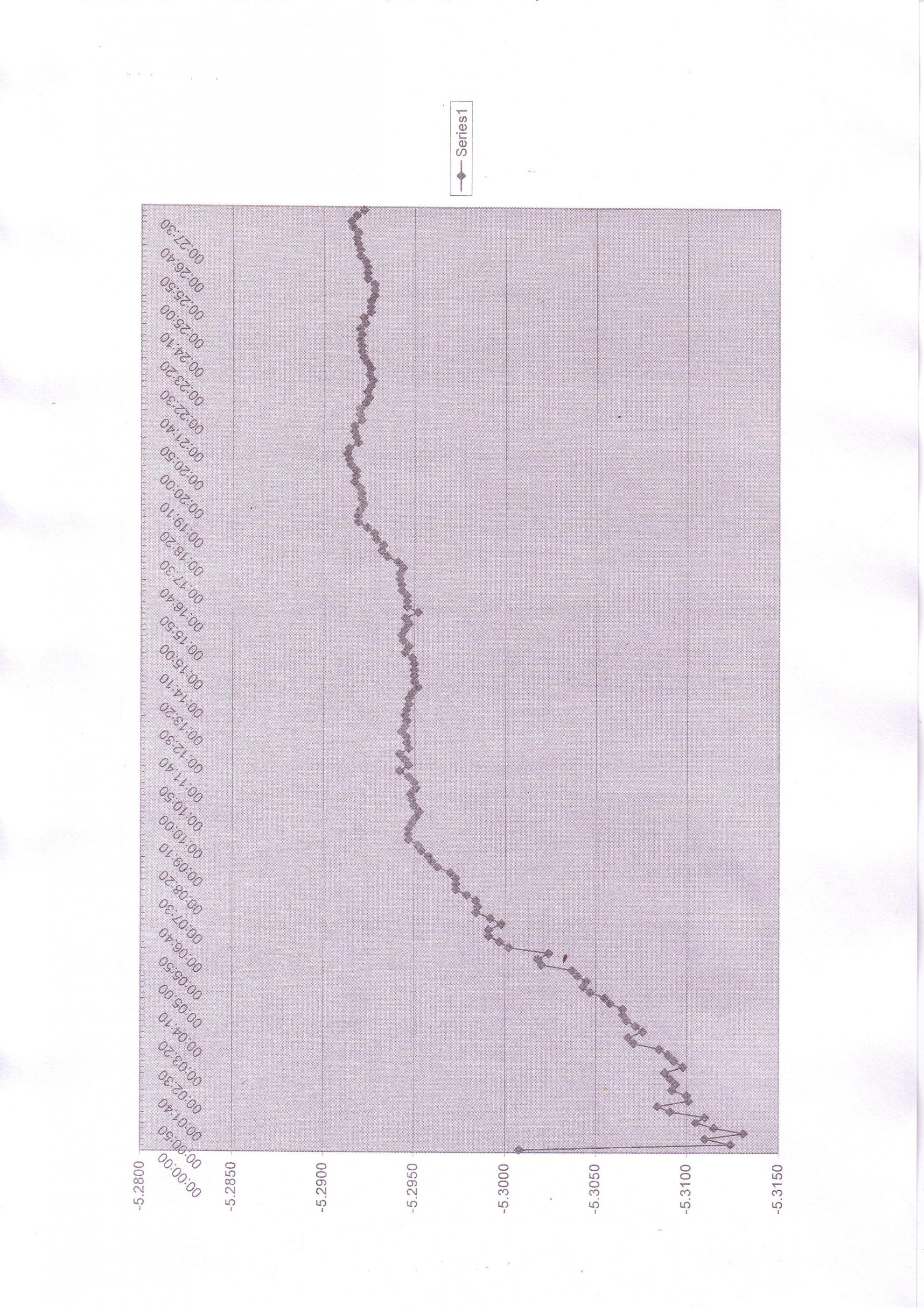

I got same FQA12P20 to match before I start I got graph of VGS from 24 to 51 C at which rig setle.
Is not perfect but if I take reading with same conditions results are prety good
