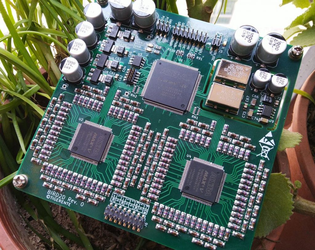

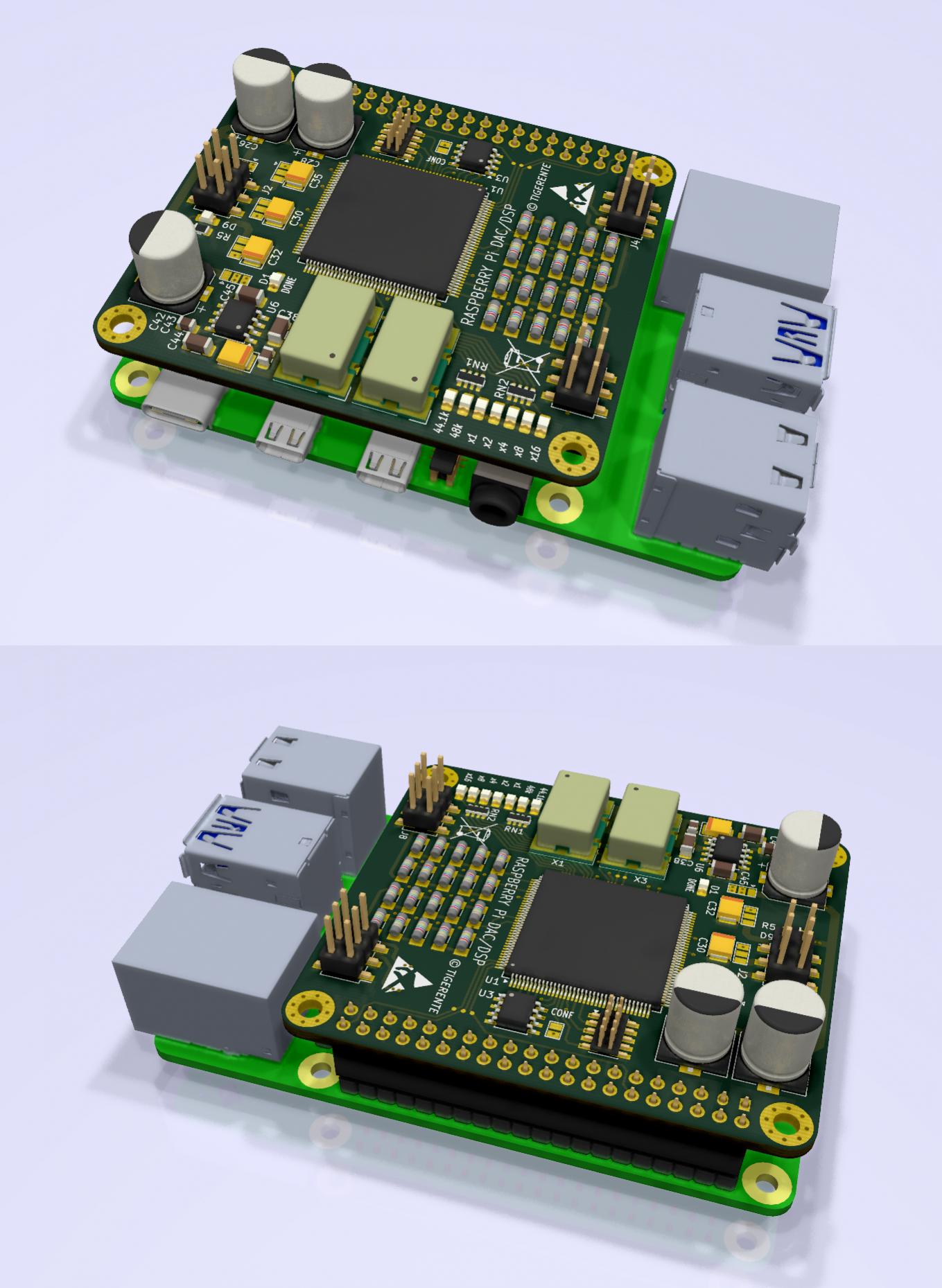

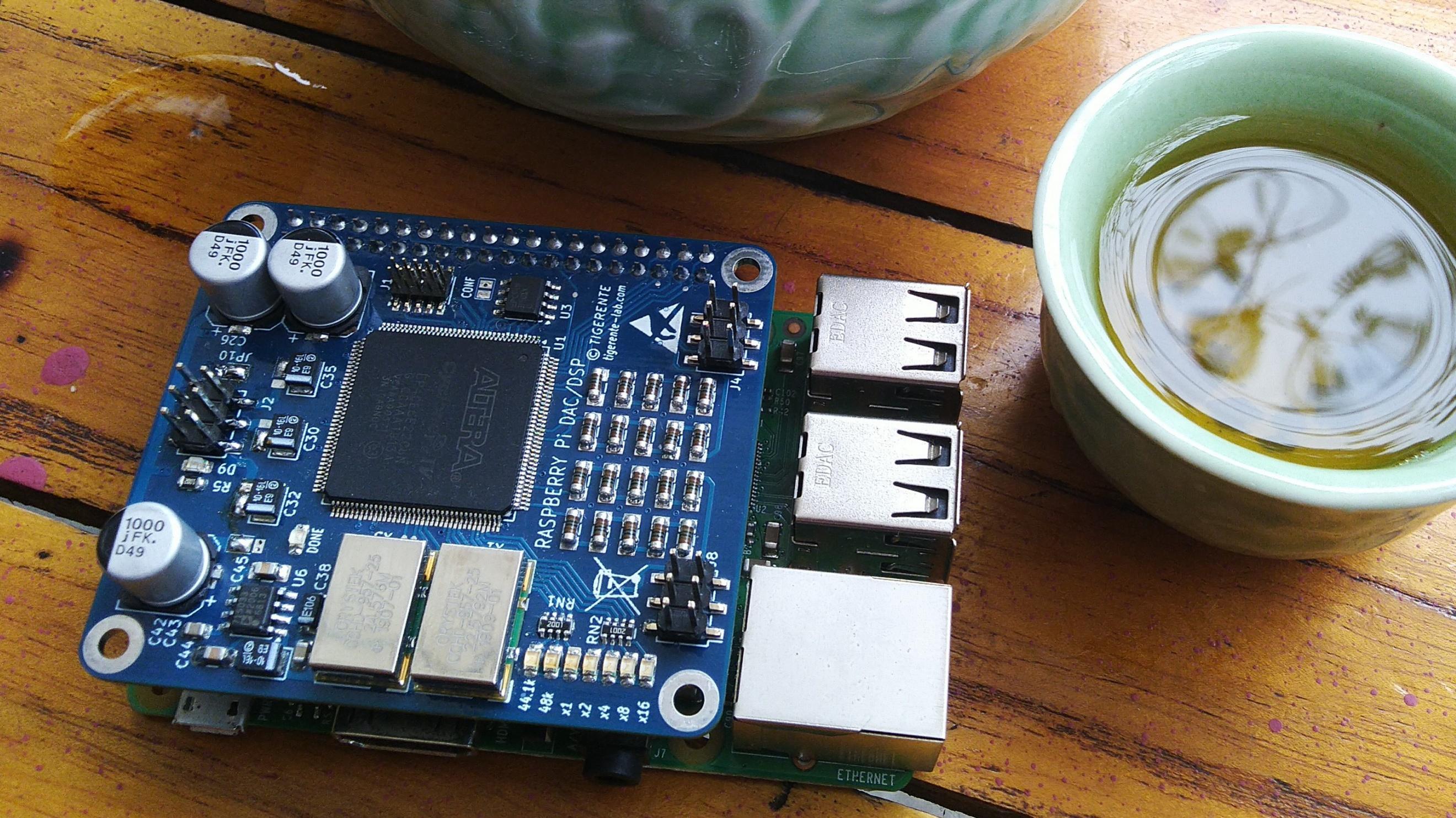

Someone said why our forum have no any FPGA-based DAC. So It’s here now. I hope someone will interested in and discuss
This DAC will be compatible with Raspberry Pi and any I2S signal.
About DAC:
+ Auto detect sampling rate upto 768khz and bitdepth upto 32bit
+ Asynchronous I2S FIFO with 2 clocks for 2 sampling rate families (x44.1 and x48)
+ Upsampling or Resampling
+ FPGA-based Delta-sigma DAC with digital filter and noise shapping.
Board Detail:
+ Intel/Altera Cyclone IV FPGA
+ 2 clocks with precision power supply (ADM7150)
+ Power supply 5V or all individual voltage for Diyer upgrade (1.2V, 2.5V, 3.3V)

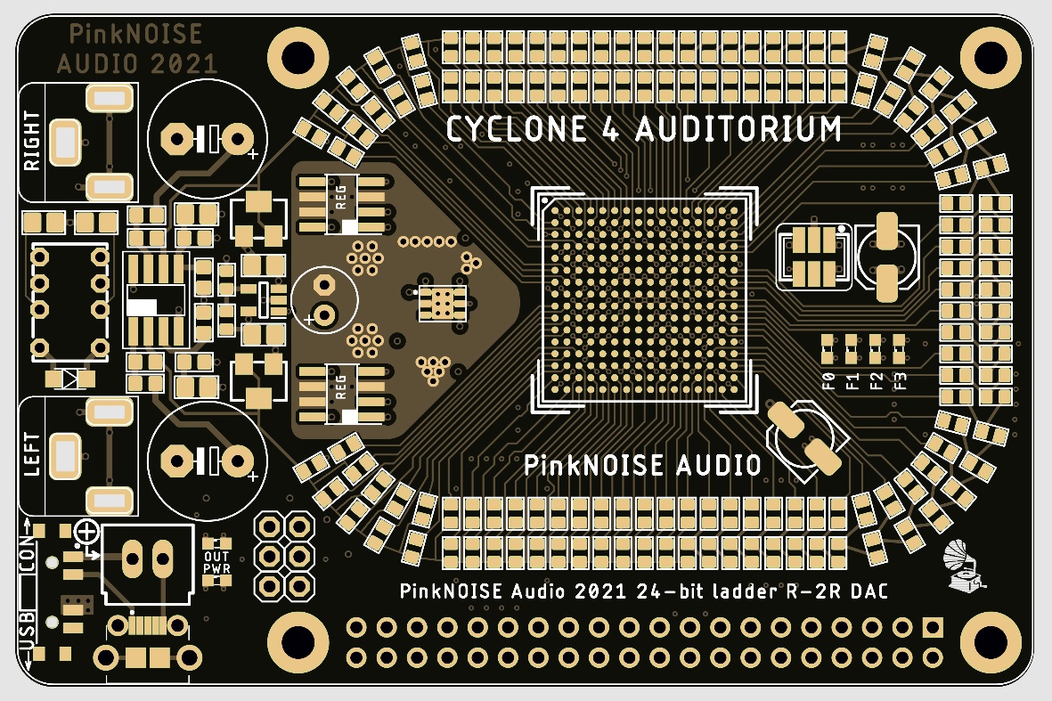

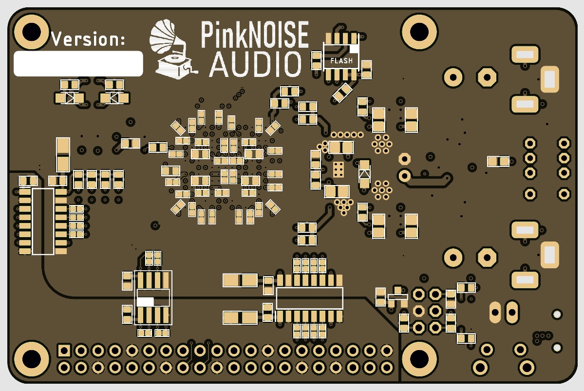

The current one is R-2R DAC (last 5-bit MSB --> 31-bit thermometer), so only decimate filters for DSD(DoP). 24-bit ladder, Altera Cyclone IV, dual 90.xxxx/98.xxxx SiLabs osc.(so 768 max), DAC as master (so no FIFO need).

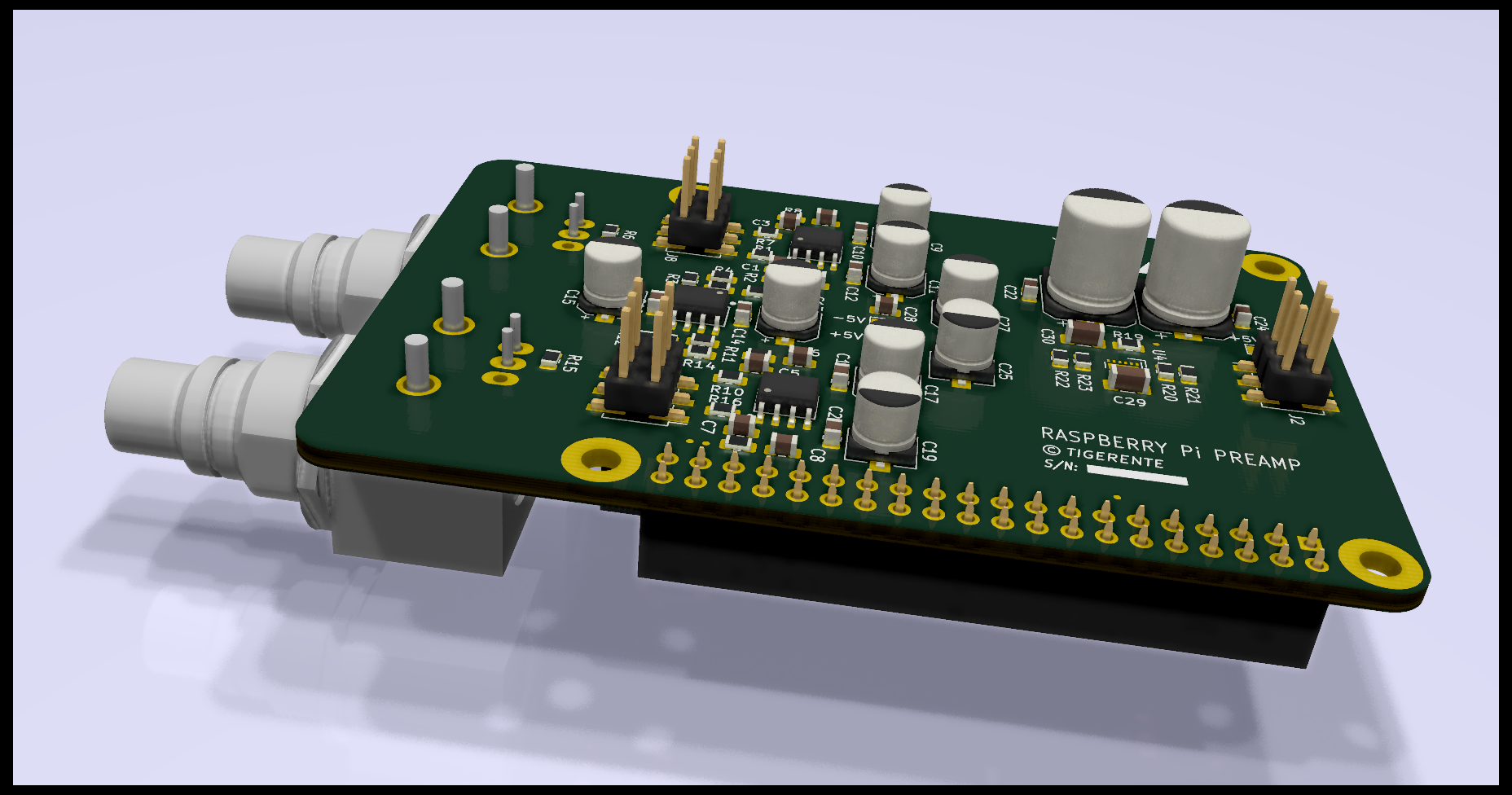

Preamplifier design is in attachment
