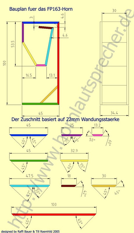

FP163 Horn
after a long time I have finally finished the plan for the FP163 horn. Hope u enjoy it.
