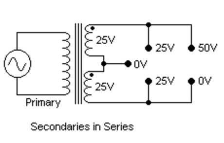

2. For the AnTek AN-0212 transfo, can I wire the secondaries in series to get both 24V and 12V like the attached pic (from ESP)? I'm hoping to build a MooseFET preamp and use the 12V for remote volume control (a sine qua non for my wife).

2/ The AnTek is described as a 0-12, 0-12 transformer, so that means two separate identical 12 volt windings. In series and you get 0, 12 and 24 volts AC or more conventionally written 12-0-12. That means you can generate a DC supply of around -/+17 volts DC or a single DC supply of 34 volts.
So your diagram becomes like this. You can have either what is to the left of the line, or what is to the right, but not both.

Thanks Mooly. Quick responses:
1. I've picked up that most people don't use a varistor, so obviously it's unnecessary more often than not. Sounds like its necessity is brought on by other errors that I don't plan to commit! 😀
2. I can't have my cake and eat it too?! Bummer. I guess I've got to get two transformers then.

Whether you need two transformers depends on what you are trying to do.
OK, I've just looked up what a MooseFET preamp is,
DIY Audio Projects Forum • MooseFET Preamplifier
This is a single rail design and so you can use your transformer to generate all the supplies you mention. The 24 vac from the transformer will go to a bridge rectifier and reservoir cap to provide an unregulated 34 volts dc that you feed to the LM317. That is using the transformer as in the right of my diagram.
You have a couple of choices for deriving a second lower voltage supply for the remote. You could add a 78xx (5v, 9, 12, etc) type regulator feeding it from the stable 24 volts feed from the LM317, or you could add a second LM317 to be fed from the unregulated supply (just as the main one) and use suitable voltage setting resistors to determine its output voltage.
Assuming I'm looking at the correct project then you definitely are nowhere near even needing to think about inrush problems with such a low powered design as this. A 200va transformer is massively oversized for a design that draws around 250ma in total. A small 30va rated tranny would be more than adequate (assuming the remote part draws little average current).

Mooly: yeah, 200VA would be way overkill for a preamp! That question was regarding an amp build I also hope to attempt (Rod Elliott's P101). And thanks for the option. I was under the impression that getting 12VAC from 24VAC wasn't quite that simple, but I'll look into it a bit more.
