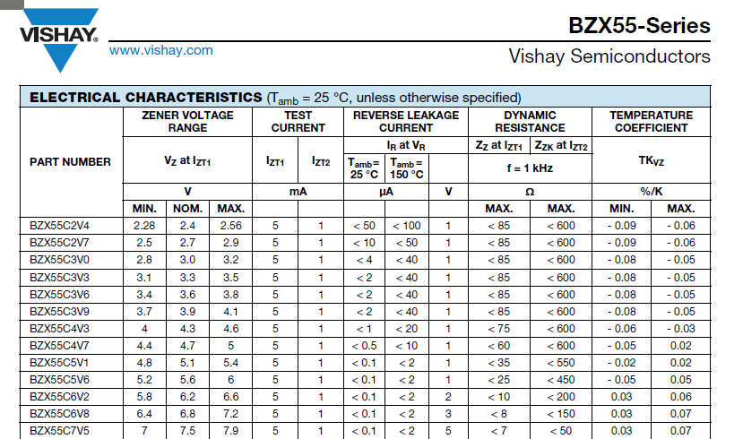

You could increase R8 and it would still work but would it be good? As it is now the zener current is around 6mA with +-35V supply and if you look in the datasheet for the old classic Vishay BZX55 zeners the zener impedance is max 25ohm at 5mA if you decrease the current to 1mA the zener impedance goes up to 450ohms so the higher current gives higher stability, and probably less noise to. As others have commented the VAS current is dependent of the LTP current so a nice and stable LTP current would be good, do you still want to increase R8?That could be perceived as a detail but FI the value of R8 is 10x lower than what would be necessary, that s just a detail among others that Elektor designs are not that well thought, they described a ton of amplifiers but there s often several flaws in their designs,
5.6V zeners have very low temperature coefficient, among the lowest you can get without going to exotic reference circuits, you still have the transistor VBE that will vary with temperature but since the voltage drop over the emitter resistor is around 5.0V, the voltage change caused by VBE change results in proportionally less current change than if you have a very low reference voltage like two diode drops. This is a pretty temperature stable CCS.
Note the tempco is -0.05 to 0,05 for the 5.6V zener, it could actually be zero if you are lucky.....

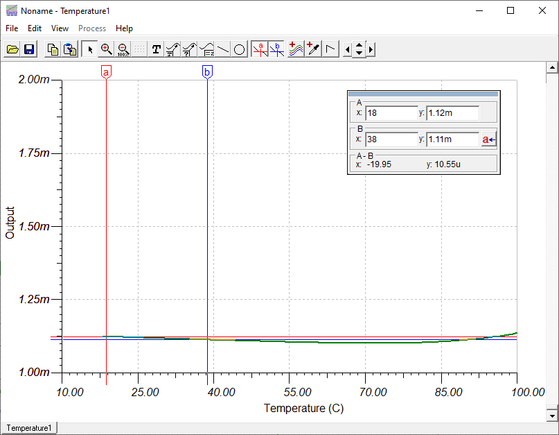

using higher voltage ref for ccs is better performance.
5.6 even 8.2 work very well.
tested it before in many circuits
at 18c current output is 1.1ma and 38c is 1.1ma
to be exact at 18c =1.12 ma and 100c 1.14 ma
current remains constant.
Unless only the zener got very very hot.
current will slightly fall. and transistor was magically very very cold.
even then constant current doesnt change much
otherwise transistor be hotter and does fine up to 100c even higher.
low voltage like switching diodes even 2 volt led
with less predictable current. waste of time
and burns up low value resistors.
1zener 1 transistor, less parts better temp co
dont oscillate. same old output impedance.

Yes, because if the zener impedance increase to 450R so does R8 to 68K, so for stability it s like a 6k8 feeding a zener that has 45R impedance as far as we re talking of the power supply voltage variation, comparatively to 25R that s not a big change, and R8 at 68K dissipate about 0.06W instead of 0.6W for 6k8, that s not all to have a higher current if components are to be thermally tortured, long term reliability is to be a concern in any design, not counting efficency.You could increase R8 and it would still work but would it be good? As it is now the zener current is around 6mA with +-35V supply and if you look in the datasheet for the old classic Vishay BZX55 zeners the zener impedance is max 25ohm at 5mA if you decrease the current to 1mA the zener impedance goes up to 450ohms so the higher current gives higher stability, and probably less noise to. As others have commented the VAS current is dependent of the LTP current so a nice and stable LTP current would be good, do you still want to increase R8?
How do you get 0.6W in the 6k8 resistor? I get 0.2448W, if the total supply voltage is 70V how high is the zener current? First we lose 11,2V total over the zeners themselves we have 58.8V left, the current is limited by R8+R11+R12 that is 9800ohm resulting in 6mA. that results in 40.8V over R8 and 0.2448W. We lose a little more over R11 and R12 because of the 0.5mA going through then to the LTP but i ignore that. The zeners will dissipate 33,6mW.

low voltage like switching diodes even 2 volt led with less predictable current
waste of time and burns up low value resistors
can you elaborate on these statements
Because I was previously working on shunt regulatorscan you elaborate on these statements
and my train of thought was backwards.
Good point with zener bias current source seems dissipation
in some resistors would actually be higher.
around 1mw compared to 10mw
looking at basic benefits/ tradeoffs
Zener bias for current source is more stable over wide temperature range.
And all in all resistor degen values used, will bring output impedance
to around 2Meg.
Common circuits using dual switching diodes or even Led, emitter degen
wont be as high. Output impedance maybe 300 to 750K
Tradeoff with zener or higher voltage bias. There is overall voltage
losses , less swing or overhead.
So not a good idea for a VAS stage or gain stages for max swing to rail.
Feedback current source more beneficial and impedance about the same.
Zener more useful for input differential, has high impedance and
more stable over temperature range. So DC offset for a amplifier
in theory wont drift as much. And if rail voltage sags.
Bias voltage still remains high enough to hold output impedance to 2Meg
With feedback current source if rail voltage sags then impedance also goes down.
Theoretically should be about 2Meg, but can drop to 1Meg
And current changes with higher temps.
always trade offs. Less loss of overhead, good for gain stage if your trying
for maximum swing to rail
Otherwise very simple Zener's more thermally stable, source impedance doesnt drift as much.
Ideal for input differential.
Hence comment for this amp and common issues with simple symmetrical amplifiers.
Best thing to use and used, be zener current source. very stable over temp range.
