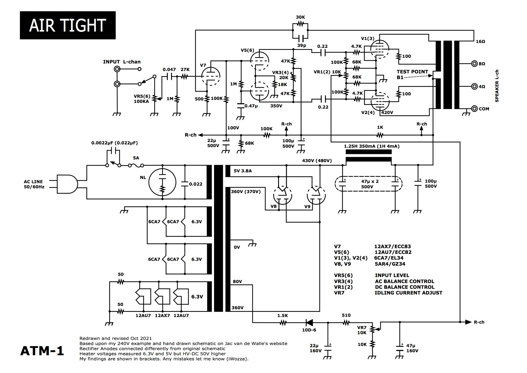

I completely disagree with you on filter capacitance. I never go over 50 uF (47uF is the same thing). Zero issues with bass and most people comment on how well mine work at low frequencies.
The output transformer is the biggest singe component that determines so many characteristics. Mine were designed by Hammond here in Canada, upgraded from the average output transformer by Chris Bacik. Sadly no longer with them.
I'm using a good output transformer with 50 uF. The bass is deep and the B+ maintains fine. That pretty much disproves the need for extreme capacitance.

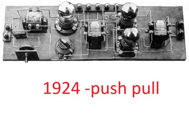

I work on equipment from the 1920's and up. We started with about 4 uF, there are probably sets with less. 8uF was very popular. The design used a C-L-C setup with the field coil of the speaker as the inductor and a hum bucking coil in the voice coil assembly. The output tube was a 45 or lower powered, single ended setup. 6F6 was a popular output tube. Current draw and output power was modest, and the other techniques did fine for dropping the level of hum. Single ended designs as you should know are very susceptible to hum.
As time went on, better engineering allowed improvements. The biggest being push-pull operation, far more efficient and much lower distortion. The phone companies really jumped on this for long distance repeaters. The best audio equipment was always push pull, were are talking mostly about large radios. The cheapest products continued with class A operation (table radios, cheap phonographs). This is all real history you can research.

@hooman if you've got anything to say about this project it's welcome here.
We aren't going to get into a capacitor debate on this thread. If you think my work is lacking in some way, you are free to build your own amplifier however you like. I'll build mine, you build yours.
The reason it uses 47uf capacitors in a octal can is because that's how the original builder had it set up.
I thought I might get lucky and do a simple recap and bring it back to life.
I was not so lucky, so rather than pitch these expensive caps in the trash, I used them and they work very well.

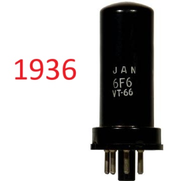

My father worked in the army and job in telecommunications, big transmiter tubes .... he repaired tube radios for many years. I had been watching tube radios since I was a child. Almost all of them were single-ended. Most were made in Western Germany. The single-ended output kept the price down, but a real class A tube and a large German full-range speaker in a wooden cabinet... a godsend of harmonics.................... But do not discount the pressure from the marketing department and public opinion. Public opinion was formed from a few marketing department s trying to create an edge for their product, much like the feature races of today.....................................
