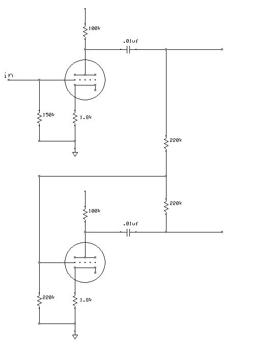

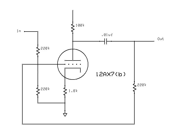

I need someone to chime in on these paraphase splitters. The schematic in post #36 shows the phase invertor using negative feedback to adjust it's gain (I assume). What are the pros and cons to this method vs. a simple resistor divider on the PI's input?
Here's that schematic again.
The paraphase splitter was popular in these console amps of this era, they sound quite nice IMO and it may be due to the fact that they are NOT perfectly balanced and impart a bit of second harmonic to the signal giving a more "single-ended euphonic" sound to the amp.
They were a low parts count cheap solution that was the name of the game in the competitive console market. If you dont already have it I suggest you pick up a copy of good 'ol Morgan Jones ED.3 and give it a good read. The various types of phase splitters are covered in good detail.

It's the way they control the gain of the invertor that I haven't seen before. I've seen paraphase used in many amplifiers but those amps divide down the output of the first triode to feed the PI.

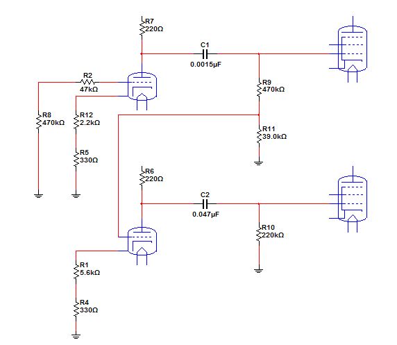

The Magnavox uses a common resistor divider with 470k and 39k to drive the PI grid. The Motorola uses a 220k and 220k divider -and- another 220k off the PI triode for negative feedback.
What are the pros and cons to each method?

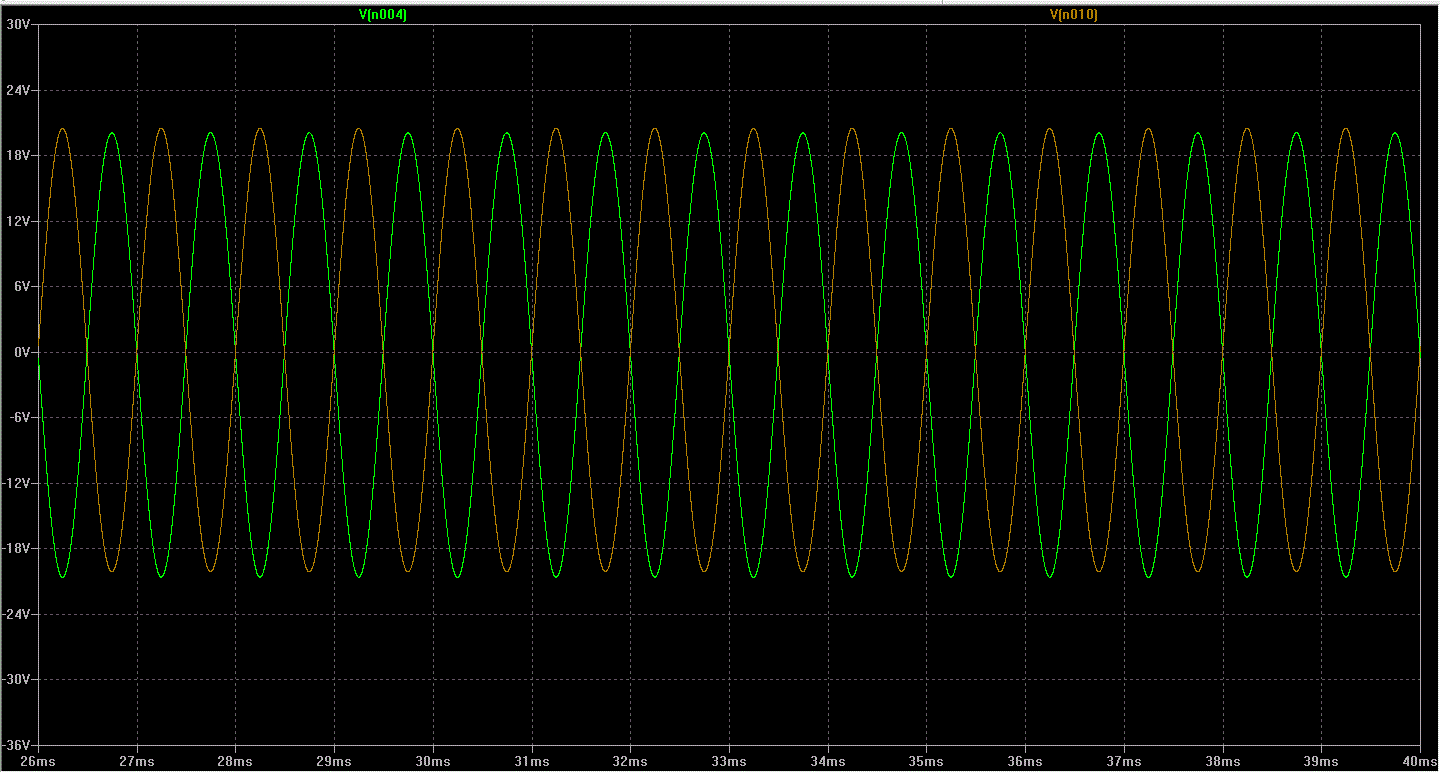

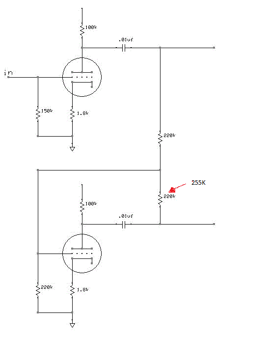

Hi, to fine tune the invertor , just trim the lower tube 220K resistor (not the one that goes to ground) from the original value to some higher figure. Spice shows perfect balance with 255K, in the real circuit you need to try and measure. That's how you can control it. Variyng the amount of feedback. It looks more elegant than the Magnavox used method, but, You say you found it actually sound worse?
Out of the three resistors... There's one off the first triodes anode, another off the second triode's anode, and the third is from the second triode's grid to ground. Which of the three do you suggest changing? I'd suggest changing the resistor from the second triode's anode to it's grid. That one should be the negative feedback and control the overall gain of that triode.

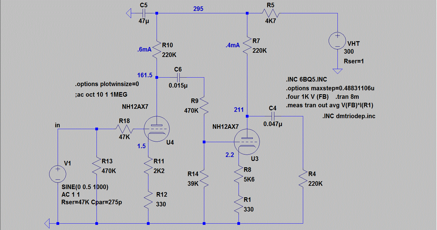

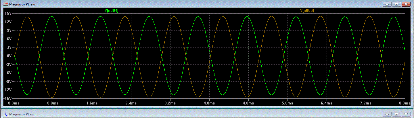

Would you have time to do another emulation if I provided the Motorola version of phase inverter?

I've read that. I'm not talking about the Magnavox amplifier's GLOBAL negative feedback. I'm interested in the way the Motorola's PI used feedback from the PI's anode back to it's grid to adjust the gain of that triode.
This is the second triode in a paraphase inverter. The first being the triode getting the audio signal. The output from the first triode is fed into the second triode to be inverted. The gain of the second triode is adjusted via. negative feedback via. 220k resistor back to the grid. I typically see paraphase invertors use a simple resistor divider on the second triode's grid.
Which method is better?

Well, in the Magnavox circuit there is a different bias for the second triode , there are different coupling caps, and different grid leak figures, I'm not an expert, but I was told in this forum, a while ago, that probably it was a cheap way to avoid oscilations and motorboating, annoyances much worse than some little imbalance.
I like best the Motorola inverter, never seen before one alike, thanks for posting
And for the common outputs cathode resistors, they said it probably creates a (light) "wide stereo" sort of effect, probably that's why it's graceful to the ear...
Let's look at this from a solid state point of view using an op-amp. If you want an overall gain of 10, would you set the op-amp's feedback for a gain of 100, then reduce the input (via resistor divider) to 1/10? Or would you set the op-amp's gain to 10 so the full signal can be applied to the input? From a noise point of view, I would think reducing the gain of the op-amp and applying more signal would reduce noise.
I wish I had a good emulator or test bench to compare the two.
