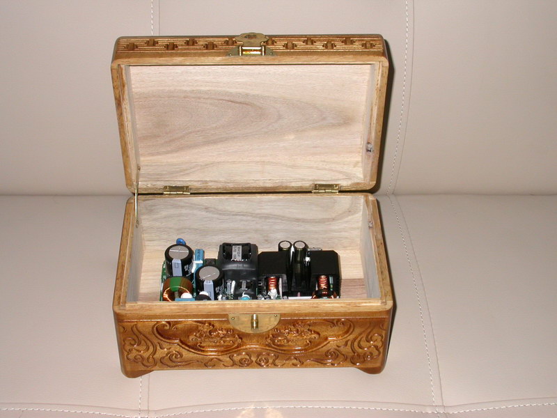

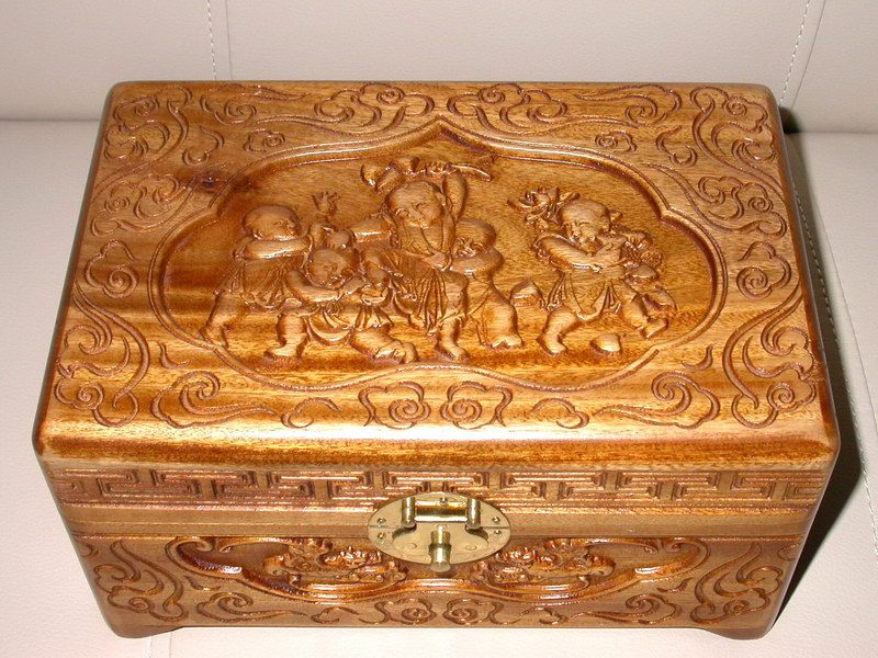

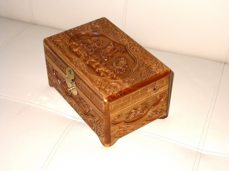

Yesterday when I shopping with my wife I found this nice wood art case. The size is just right for fit in the module. I bought it without hesitate despite of the damn high price. I'm going to show you how I make it into an amp in this thread. I had never made a enclosure like this so please advise if there's any.

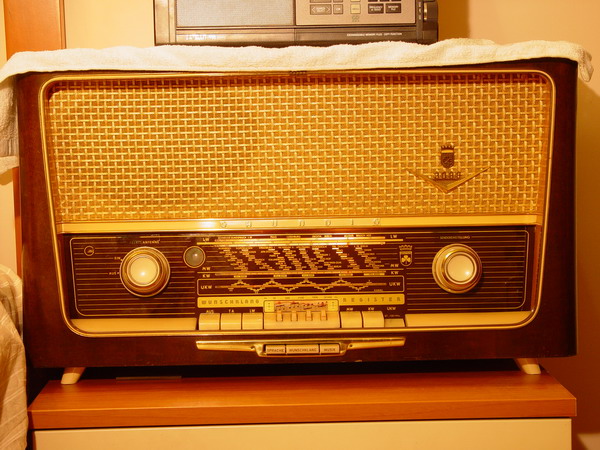

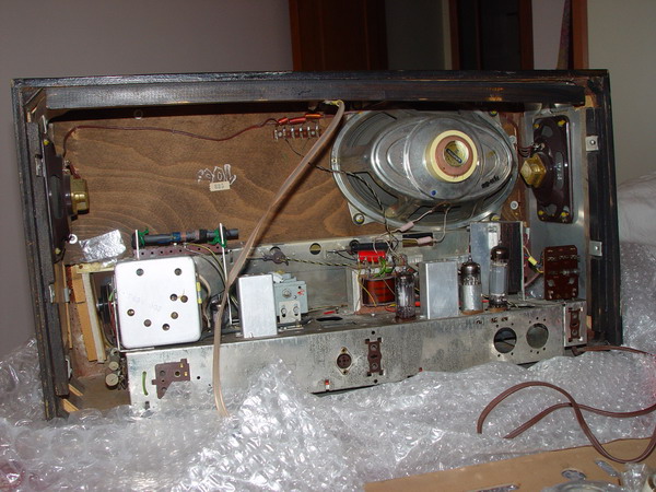

I don't think wood is not a good combination of electronics. Look at the photo, it's one of my most favorite collection, a Grundig 3088 tube AM-FM radio receiver in 1950s. It has 8 valve tubes as I remember, the power consumption is at least 10 times higher than 125ASX2 module. The case are all made of wood! You can find a lot of electronics stuffs in those days (or even today) has a wood enclosure or chases (how about active sound box?)
The first problem I need to solve is where shold the connectors positted? There're beautiful hand made art sculptures on 5 sides of the box, It's not a good idea to damage them. The only choice is the bottom side. I have to find a good solution to connect the cables through the bottom of the box.

Yes I agree. Of course I won't mount the board on wood directly. Actually there's no way to doing that way, at least several brass braces are needed.
As I said the box will be pasted with copper sheet all around inside to reduce noise. A metal chassis will be placed between the module and the bottom of the box.
Connectors on the bottom wouldn't work well for RCA connections, unless you recessed them very deeply into the box. Or used very tall feet.
Holes in the bottom plus holes in the back should allow air circulation for cooling. Otherwise the box becomes an oven.
But there's beautiful sculptures at the back side. I don't think anybody will like to damage it. There are 4 legs on each corner of the bottom, there's abut 15mm gap betweem the bottom plate and desktop. I think the RCA could be mounted horizontally. Maybe a 3.5mm headphone jack is another option?
Almost Done!
I made a PCB as back plane of 125ASX2. Then cut a square hole at the bottom of the box. The cables are connected through the DIN connectors at the bottom.
Drilled 2 small 8mm hole in the front panel of the case, left is power switch, right is voice potentiometer.
